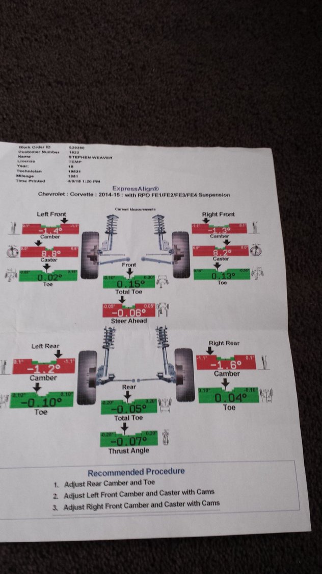

Same thing happened to us. But come to find out the dealer was aligning to the fe4 platform I stead of fe6...but still off. They refunded our money. Here is how they set it uo. We ended up raising it up a little and having a different shop align it.

That's ridiculous! Go to a reputable alignment shop. Not only is my car lowered on stock bolts, they are cut to the top grove. Rory's in AZ aligned it without a problem quickly and with print outs. You should start taking your car somewhere else.
