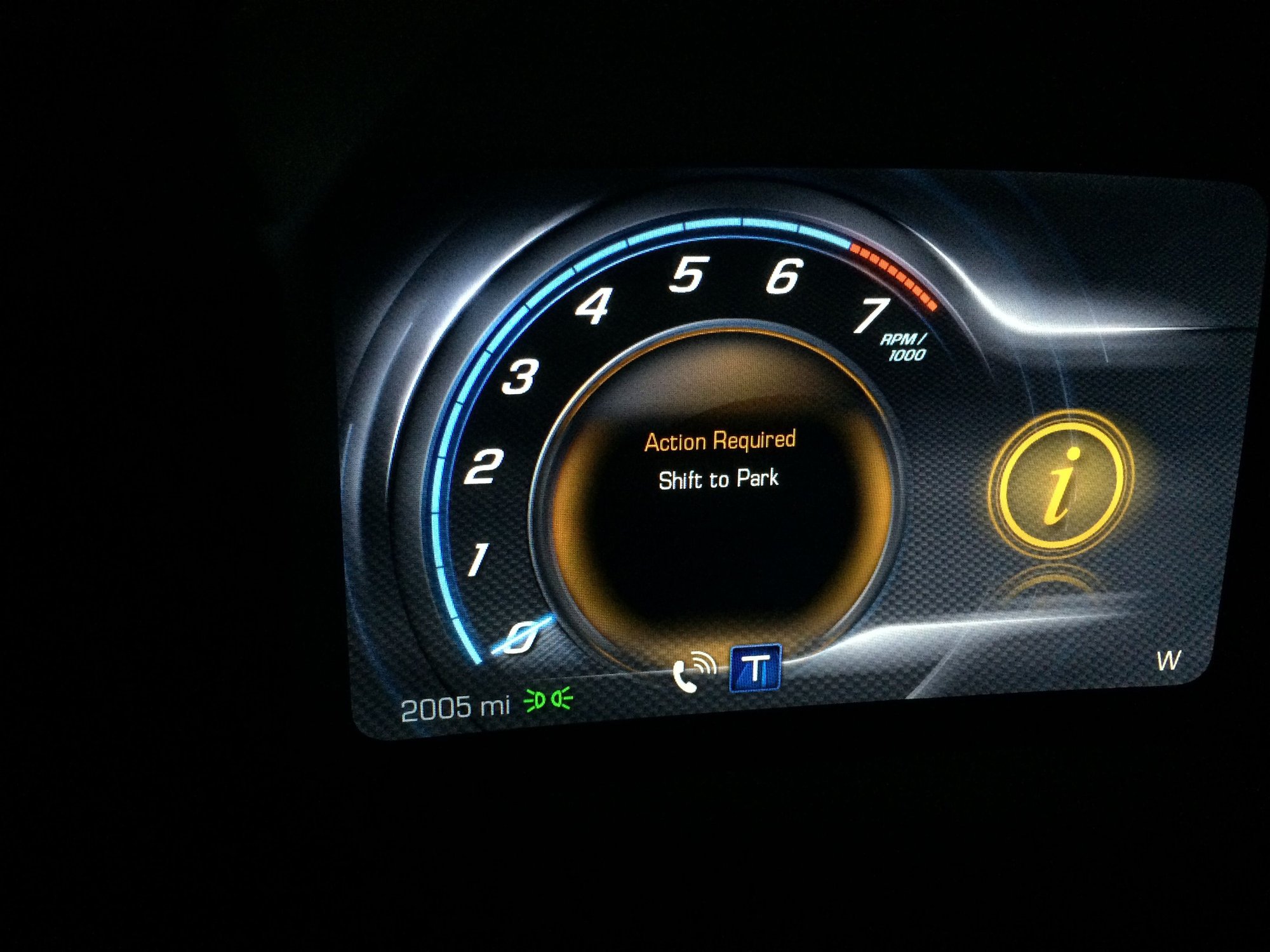

came home and pressed engine start/stop button. engine stop but all electronics and lights stay on with this error
car will not lock, give two chrips like the keys are in the car.
I drove car around in every mode and turned off and on numerous times. In every permutation of gears and modes.
very strange. having it towed since I cannot turn off any electronics or lock car
this happen to anyone?
