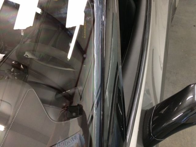

Installed our poly carbonate windshield today. Lots of things learned but overall we are pleased with the results. A definite must I feel if you track the car often. Things we noticed, the mirror and camera assembly are integrated to the molding not stuck on the windshield like most cars. It then actually clips in to the windshield. Since no clips are on the poly windshield, we just used double sided tape. Other thing is because it had some anti scratch on the poly windshield, we had to use silicone rather than urethane so it would bond. Also, we didn't have time, but the black siding that you see on all windshields (that's baked into the glass) will go on as well. We are going to use vinyl so you won't see the silicone and camera housing to make it a more OEM look and a cleaner look as well.
Pros: safer for track application cars and it is 13.6 pounds lighter. 19.4 vs 33.
Cons:
Haven't verified but I think you will lose the heads up display. I just hope the camera still works. Also, I'm not sure but you might not pass inspection but I don't think they can notice unless they press on the windshield.
Finally, does any one know what this sensor is on the pic below?

From: Houston Texas
Don't quote me but I believe that is the GPS sensor.
Ok thank you. Let's hope it still works. I was told it was a rain sensor but questioned that as we don't have automatic wipers

thats the pdr camera
