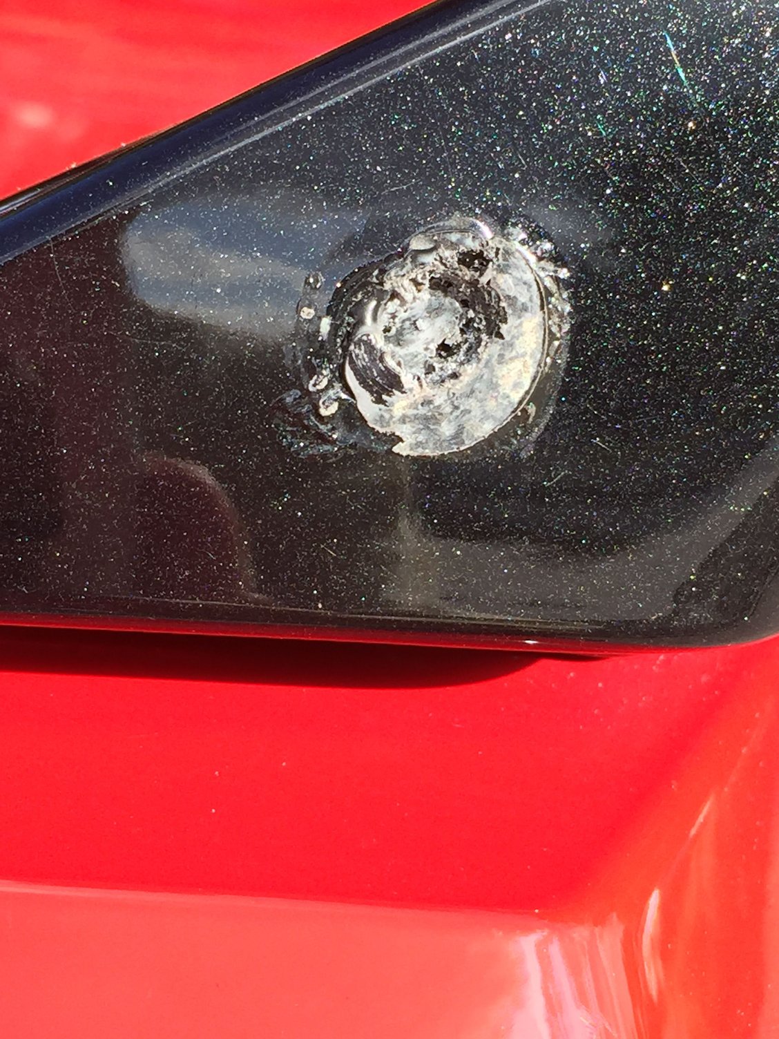

Was just washing the car noticed something around this rear spoiler screw. It wouldn't wash off so I got a socket to remove the screw-it took about 1 oz of pressure and the screw head came off leaving this ugly mess. What the hell's going on-This Z06 was built in Sep and a screw is
corroding like this? Man this is not a confidence builder. Anyone ever have this happen? Off to the dealer Monday..........

Looks kinda like they broke it installing it, then glued it in place.
Dealer should cover it.

That sucks. I wonder if they crossthreaded it when putting on the wickers, then broke and glued it.

Two folks mentioning gluing a broken screw into place-man that's scary-but I agree-I probably could have pulled the head off with my finger nails. So, this would have been done at the dealership?

This is corroded, what you have looks to have been glued.

More evidence for them gluing in this screw as the screw base is shiny and that hole has no shiny metal. This is unbelivable

I'm pretty sure that spoiler section is installed during the PDI. If so, the dealer owes you a new left side spoiler, as the paint is messed up from the "glue". Good luck...

The screw is probably broken off in the insert in the base spoiler. All of that crud and glue is on the stage 1 wicker that's bolted to it.
So hopefully they can pull off the left side wicker, use a screw extractor to pull out the broken piece, and reinstall a new wicker.

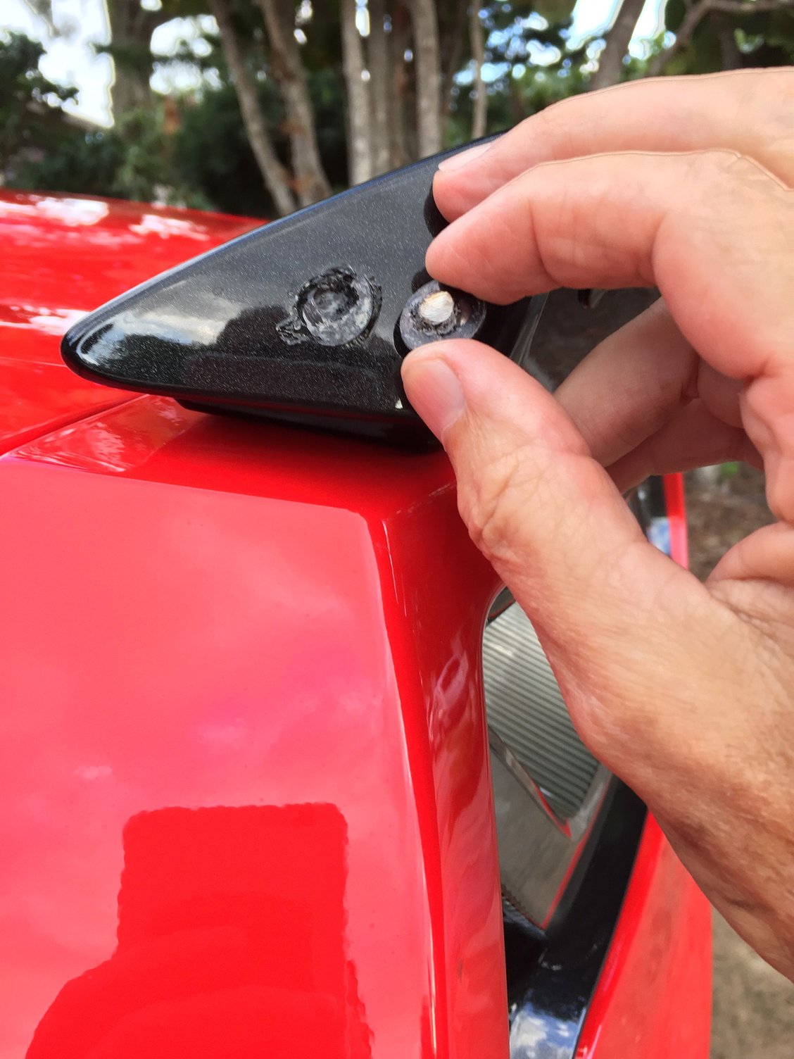

Let's go back to that pik just a bit There are gouges on the outside of the screw hole...Did you not notice them? As well, that hole is far to big compared to the original I think. Does it appear that they actually cut the hole of the spoiler bigger to accomodate gluing the screw back in? It is one thing to sy the bolt was broken and screwed but this appears to be a spoiler replacement doesn't it? It almost appears that they fixed it with a super-adhesive or crazy clue and when you removed the plug, it actually ripped the surface of the the spoiler panel. Post a pik before you noticed...Im sure you have one with that stunning car.

It appears the dealer's main mistake was not using strong enough glue!
Hopefully, it did not damage the base of the spoiler and they can just replace the extension.
In the photo, it does not even look like the base of the screw is in the hole??

You are right. A new wicker has been ordered. Service manager says he'll show me what's under that mess and how they plan to get it fixed-if I can't be there, he will send pics.
