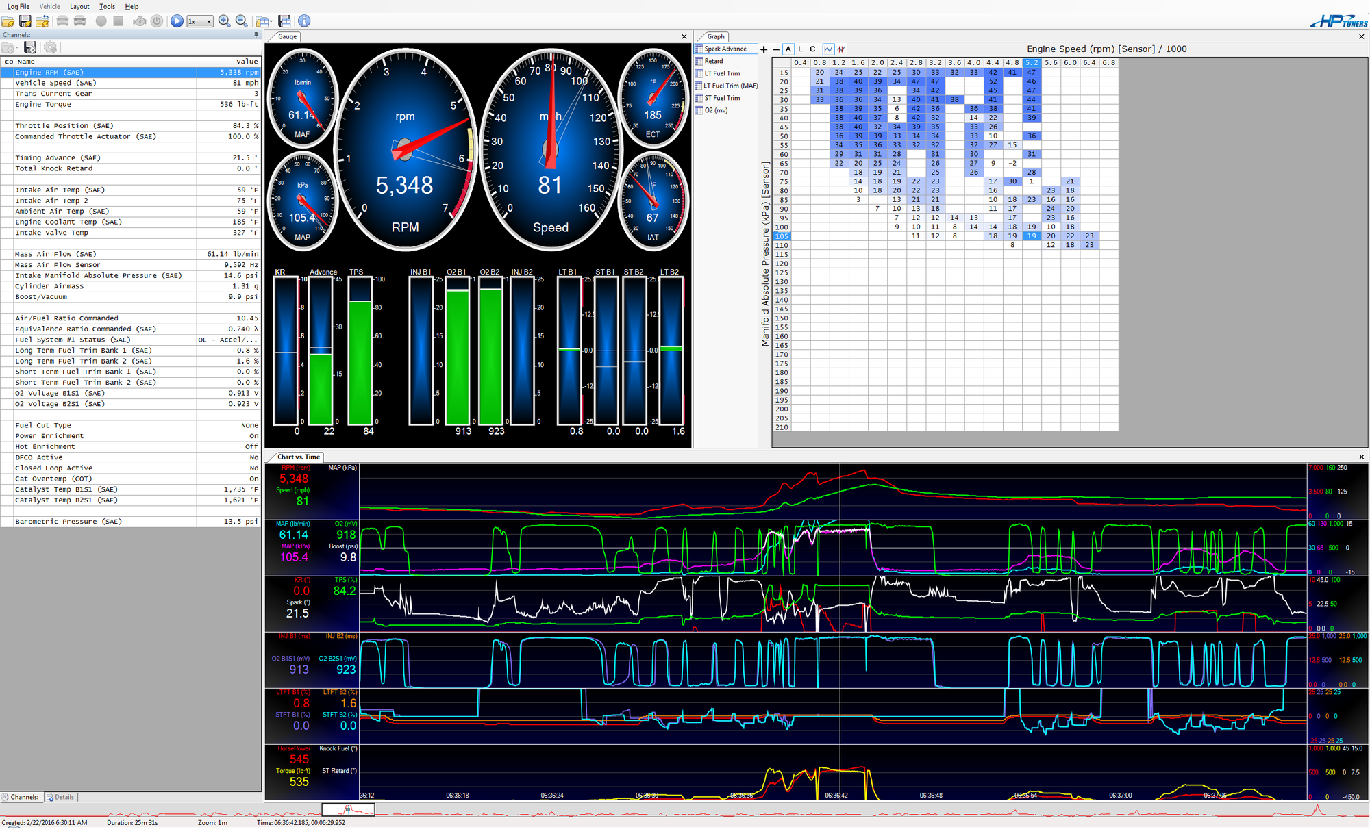

I looked at a few logs and here is an example of torque in 3rd and then right after shift to 4th, I do not see any evidence of reduced power mode:
3rd gear
4th gear
Old Mar 16, 2016 | 03:50 PM

As I stated above with the picture of logs I have not seen this, what are you feeling on the shift? My car has a Halltech intake so its making 45-50 more rwhp than stock. Are you getting a check engine light? Anything to make you think its reducing power tremendously?
