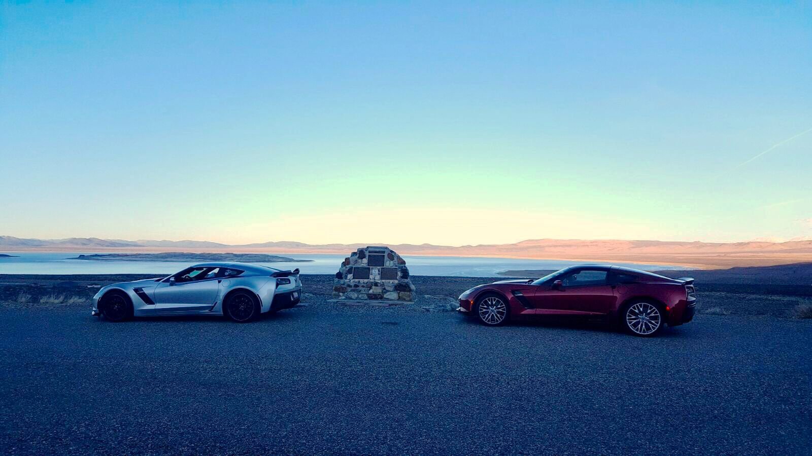

Last weekend Pete and I did an exploratory trip to Lone Pine CA to plan for an upcoming Corvette Weekend. Pete has a 2016 M7 and I have a 2015 A8 and for the entire 1200 miles nose to tail from Sea Level to 10,000 ft we used the exact same amount of gas. We also both have the Halltech CAI. Since I've been told the automatics loose more HP then the manuals and I pay the $1300 gas guzzler tax can someone come up with an explanation for the gas use.

Is the M7 the silver car?
EPA mileage is also a combined fuel consumption and from you're saying the bulk of this was highway driving.

Judging from the picture, one is a stage 2 and 1 is a stage 1. This will cause a drastic difference in MPG. I have a buddy with a Stage 3 with ZO7 and M7. Mine was originally a Stage 1 with the A8. We did a road trip and his MPG was a lot lower than mine.

Silver car is M7, and as far as highway use, well these highways are in no way what one might call an ordinary highway. Switch backs, altitude changes combined with high acceleration episodes. Majority of trip were altitude levels between 3500 to 10,000 ft. As far as stage one vs two, well at the speeds and altitude changes we went through I find it a stretch to think one inch more spoiler would change much.

I think it matters more than you believe. That extra inch provides a lot of air drag at highway speeds. For a normal car to go 70 mph on a level highway it takes about 30 HP no matter what type of engine is used. The only thing that counts is frontal area and coefficient of drag. The extra inch on the rear spoiler doesn't affect frontal area but it sure does affect coefficient of drag.
I bet if you removed even your limited rear spoiler you would see a measurable difference in fuel economy.
Bill
Maybe at sea level but not so much when you're up nearly two miles in altitude.
Also he didn't have the center piece installed.

I'm Pete, The Phantom's owner. I's a M7 with Stage-2, Halltech CAI, Corsa Helixx + Xtreme, and catch can.
The MPG was a steady 21.5 MPG. This Vette is the first car that the computer is right on with the gas pump. My C4s, and my C5Z06's MPG's gauge is way off from reality.
We drove on the 395, up & down mountain roads, city, no racing.

In the case of the two cars in question, the one with the A8 does have more driveline loss and also has lower overall gearing in it's final gear(8) of 1.57:1. The car with the M7 does have lower driveline loss and also has higher final gearing(1.54:1). Those two elements favor the M7 for best gas mileage.
That means the car with the M7 should have better gas mileage at highway speeds. BUT, the M7 in question is not as aerodynamic at highway speeds with it's add-on devices thus uses more gasoline.
I believe that the M7's aero is what drug it down to the A8's fuel consumption. Aero in play. If both cars had had the same transmission, then the one with the stage 1 aero, would have produced the best fuel economy.
