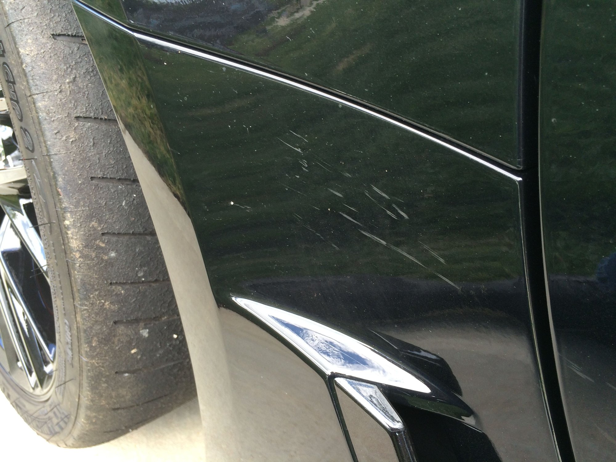

Here is what happens with ACS Mud Guards and Side Skirts. One picture shows the tire rubber thrown by the front wheel while I was on track last weekend. This is on the right side quarter panel. The other picture shows the ACS Mud Guard and Side Skirt on that side.
If you have ACS Mud Guards and Side Skirts and aren't getting debris hits on the sides of the car you aren't driving fast enough. While I was cleaning the car I found I was getting hits on the door above the crease and I thought the crease stopped that so I only added Expel below the crease. Now I will have to add door protection each time I go to the track or get the Expel coverage over the complete door.
