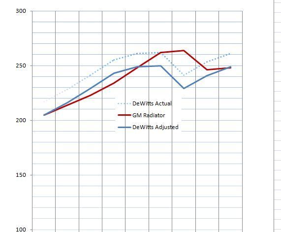

I received some radiator test data I'd like to share however before I post the numbers I would like to hear your input on how to interpret the data.
Car #1 Is a non-modified 2015 Z06 with A8 with GM Factory radiator
Car #2 Is the same with DeWitts Radiator.
The ambient air was 75 degrees. Both cars were driven, with AC, and warmed up however, this test was started with different ECT and EOT.
Car #1 Started tracking with 205 ECT and 190 EOT
Car #2 Started tracking with 217 ECT and 234 EOT
Should the temperature numbers be graphed as is, or should the numbers be adjusted so they start at the same temperature?
The car with the DeWitts radiator started 12 degree higher coolant and 44 degree oil. What do you think?

The best course is to post the data as is but point out things like starting temps. What really matters is the stabilizing temperature. If you have enough data there should be an obvious tapering off as run time increases.

^agree. I'd guess the difference would be negated after just a lap or two. Clearly car 1 was just getting going and I bet it didn't take long to heat up.

ECT 217 228 241 255 261 262 241 253 261 DeWitts
ECT 205 214 223 234 248 262 264 246 248 Stock
ECT 205 216 229 243 249 250 229 241 249 Adjusted

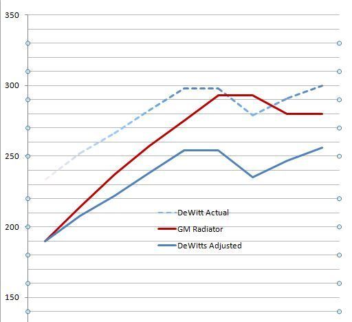

EOT 234 252 266 282 298 298 279 291 300 DeWitts
EOT 190 214 237 257 275 293 293 280 280 Stock
EOT 190 208 222 238 254 254 235 247 256 Adjusted

Can you post and graph the deltas between laps? IE Lap 2 minus Lap 1 temp, Lap 3 minus Lap 2, etc for each. Was the same driver in each car at different times or different drivers at the same time? All hot laps or were some cool down? I think we need the lap time for each value to make sure we're comparing apples to apples.

In the above test both cars failed into the fifth lap. Then the cars did a cool down lap and finished. You can see the DeWitts radiator recovered much faster.
I feel the adjusted curve is a more accurate interpretation of what would take place. Nine gallons of oil at 40 degrees higher is a significant amount of heat.

For the adjusted plot, it seems more sensible to shift the OEM plot to the left until the two graphs intersect at 217. Or move your radiator's plot to the right.
Shifting up or down like you've done here changes the stabilizing temperature. I don't think either stabilized. They both built heat until they overheated.
Cooling this car is pain. The struggle is real.
EDIT: the reason why the starting temps are higher is important too. Say both cars had the same run time but the Dewitts built up more heat idling in the grid. In that case no adjustment should be made.

SBC is right. Shift the graph right to adjust the temp start point to be equal. The slopes look rather similar to me meaning they build heat at similar rates. The Dewitts is slightly less steep but the improvement looks small.

The 20 minutes between sessions is more than enough to bring the ECTs down to 200. So unless the recording of the data started mid session it's hard to see why the starting temps are 217*. Unless my timing app screws up and fails to record the first few laps my ECTS always start between 190 and 200.
Anyway, the stabilizing temp is what is most important.

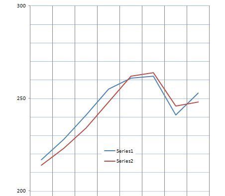

Like this?

You need more data. Who drove both cars? What were the lap times that went with those temperature levels? I think you also need the time duration from start to finish. The data as they say has to be normalized. SBC suggests shifting the stock cooling data until it closely matches the DeWitt data. I assume each measurement is taken from the Cosworth Software and is on a lap basis. So lining up the DeWitt ECT at 217 and the stock at 214 looks good but the EOTs don't cooperate, they are far different for the two similar coolant temps.
One thing I think has to be done is to plot both ECT and EOT and study the slope of the increase in temp Vs time. However, you need to have some time and performance data to do that. Comparing the rate of change is probably more important than individual temps per lap.

From the test data numbers, both the stock and DeWitt equipped car are getting coolant temps above 260F. Stock one gets to 263, then 264 F, while the DeWitt one gets to 261, then 262 F. Statistically that is the same temperature as the sensors for coolant temp must easily have 1-2 degrees F variation between them. So it looks like a wash between the two cars in terms of coolant temperature.
In terms of oil temperature, the stock car gets to 293 F, and then 293 F on the next lap. The Dewitt car looks like it is getting hotter than the stock one as it runs up to 298 F and then again 298 F, then up to 300 F on the last lap while the stock one goes up to 280 F. A 5 degree difference in EOT is not much, and likely also a wash between the 2 cars.
With temperature differences of 1-2 degrees for ECT and 5 degrees for EOT, it is hard to say if there is any improvement since one would have to use identically calibrated temperature sensors in both cars to know if there is an actual difference. If the temperature change was something like 20 degrees, then that would not be simply due to possible sensor variations.
