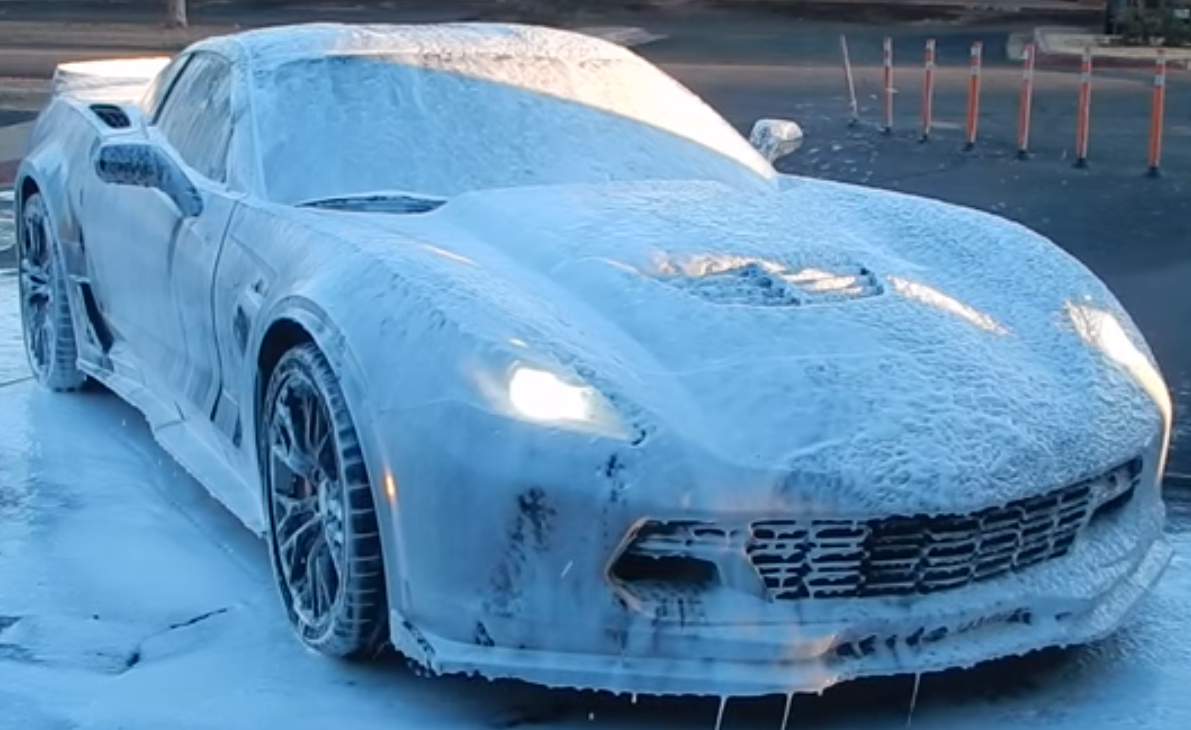

C8Jake's Avatar
C8Jake
Posts: 10,118
Likes: 5,437
From: ►SICAMOUS◄
FOAM BLASTER...eheh

AllFlash's Avatar
AllFlash
Joined: Aug 2014
Posts: 2,074
Likes: 440
From: Fonthill Ontario
I would DEFINITELY NOT be hitting my engine with a high pressure sprayer and soap as this clown suggests. BAD ADVISE! Perhaps we might read the title of the thread before offering ill considered response.
