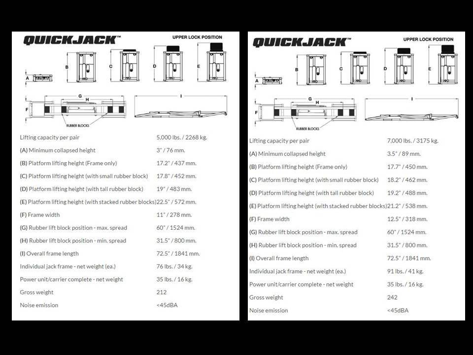

Are you sure about that? The specs list the min/max spread and frame length the same for both the 5000 and 7000. I want to order the 7000 just for the extra 2000lb cushion but will get the 5000 if cars with a shorter wheel base than the Z won't fit.
