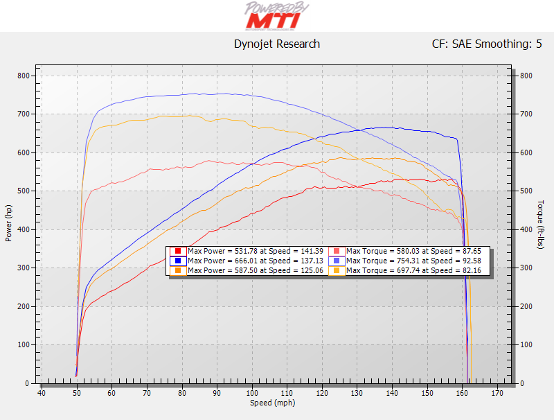

Here is a Z06 we did all the same modifications you are looking for. Its an A8. Stock, 93oct, E85.
Am I reading your post correctly?
You picked up 56 horsepower over pure stock with a Halltech AND a TB, pulley with long tubes with a tune, on 93 Octane?
Then you switched to E85 and a tune(along with the Halltech, TB, pulley and long tubes), and you picked up 135 horsepower over pure stock?.
Lol, yes that is exactly what I am saying. And look at the Tq numbers. Those are even more impressive in my book.
