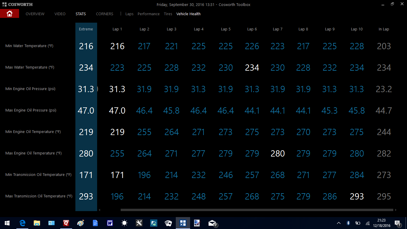

I have an M7, and you can see some temps in the screen shots below of 30 minute sessions at Daytona, and I never got any kind of high trans temp indication.
You can see the date/time at the top of the pictures.
The first one was a hot day - ambient temp was around low to mid 90s. It was after lunch, so had been cooling off from the morning sessions for about 1-1/2 hours, and the min trans temp was in lap 1 and was 171°.
The second picture was on a cool day - first lap of the day and temp around 70°.
Bottom line - even with trans temps in the 170s you've got a loooooong way to go before you're overheating the trans fluid!!

The only thing that got me more concerned about temps was a plastic like burning smell coming from the trans cooler area after drives. Seems to have subsided now but the only things in there are the cooler and the pump. My max trans temp at Sebring last week was 225F so things are still within the operating range. Just seemed like a 20-30F climb from where I recall it was.
