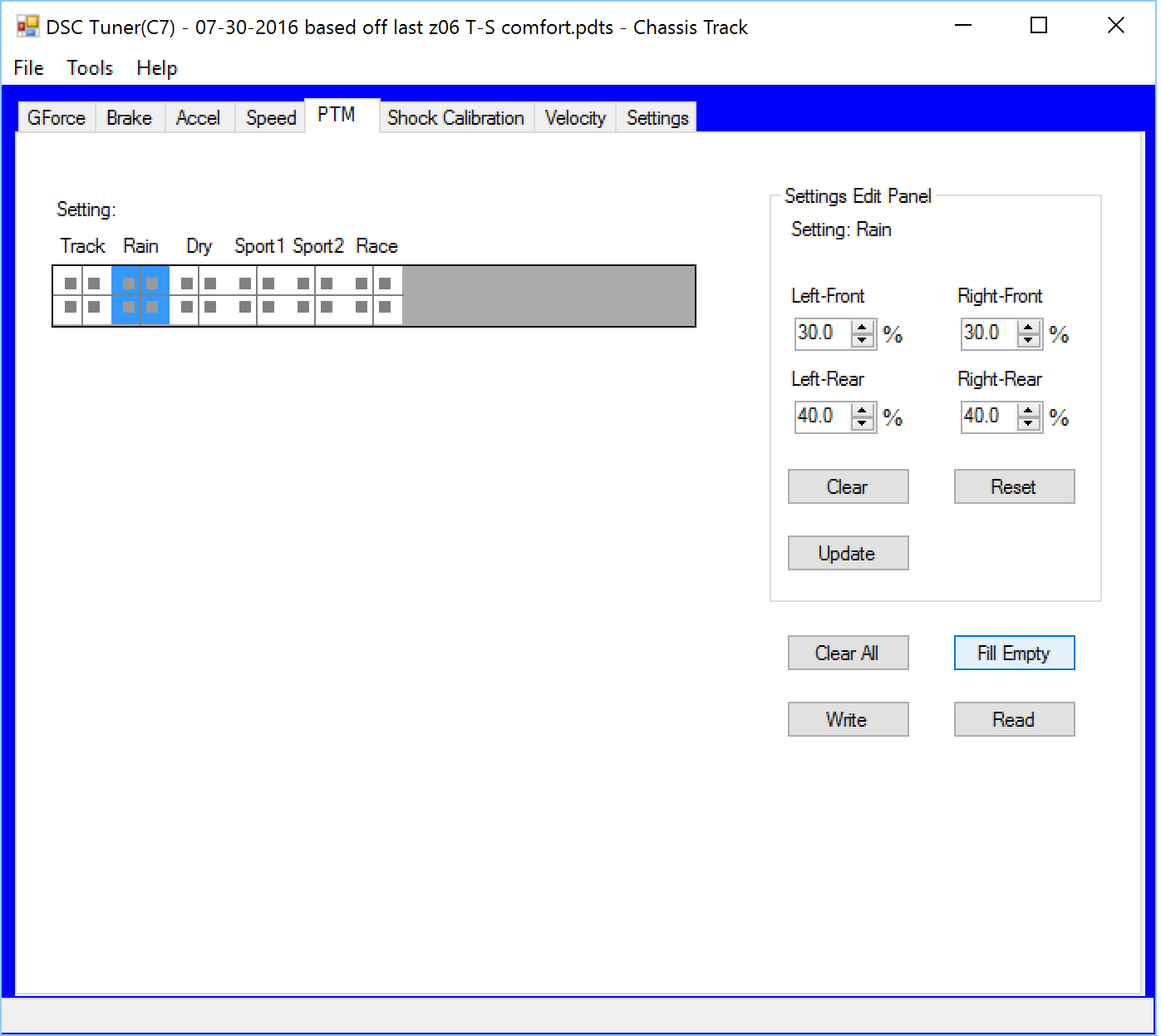

Hey Mike - below is a screen shot of the C7 config with velocity for the Tractive shocks. It looks like you're taking 10% out both front and rear.
Based on your comment above about taking 20% out of the front and 10% out of the rear I assume it should look like this?

Poor sha, Darn your good real good yes on all points on the tractive shocks I was pulling 10% front and rear and its probably close with the tractive although I would go 15% front 10% rear. typically you look for lots of front grip in the rain it is usually the limiting factor in lap time. plus remember you usually go full rear aero in the rain.
I would go softer on the magnetic due to the nature of the mag shock it is all low speed 0-2 inch/sec. you have to be careful with mag in the rain and keep them relatively soft because of this.
your tractive damper that we created the valving for has way more range we have tuned them from 0-20 inch/sec they feature a digressive piston and shim stack and have a huge range

Question for you: A value of 40 is a 20% reduction from a value of 50. If 50% in the PTM settings leaves the shocks alone (100%), is a value of 40% actually reducing the shocks by 20%? I'm wondering if that's why the wet setting is so soft.
Or is the math not coded that way? Curious how the PTM values actually affect the shock table numbers.
