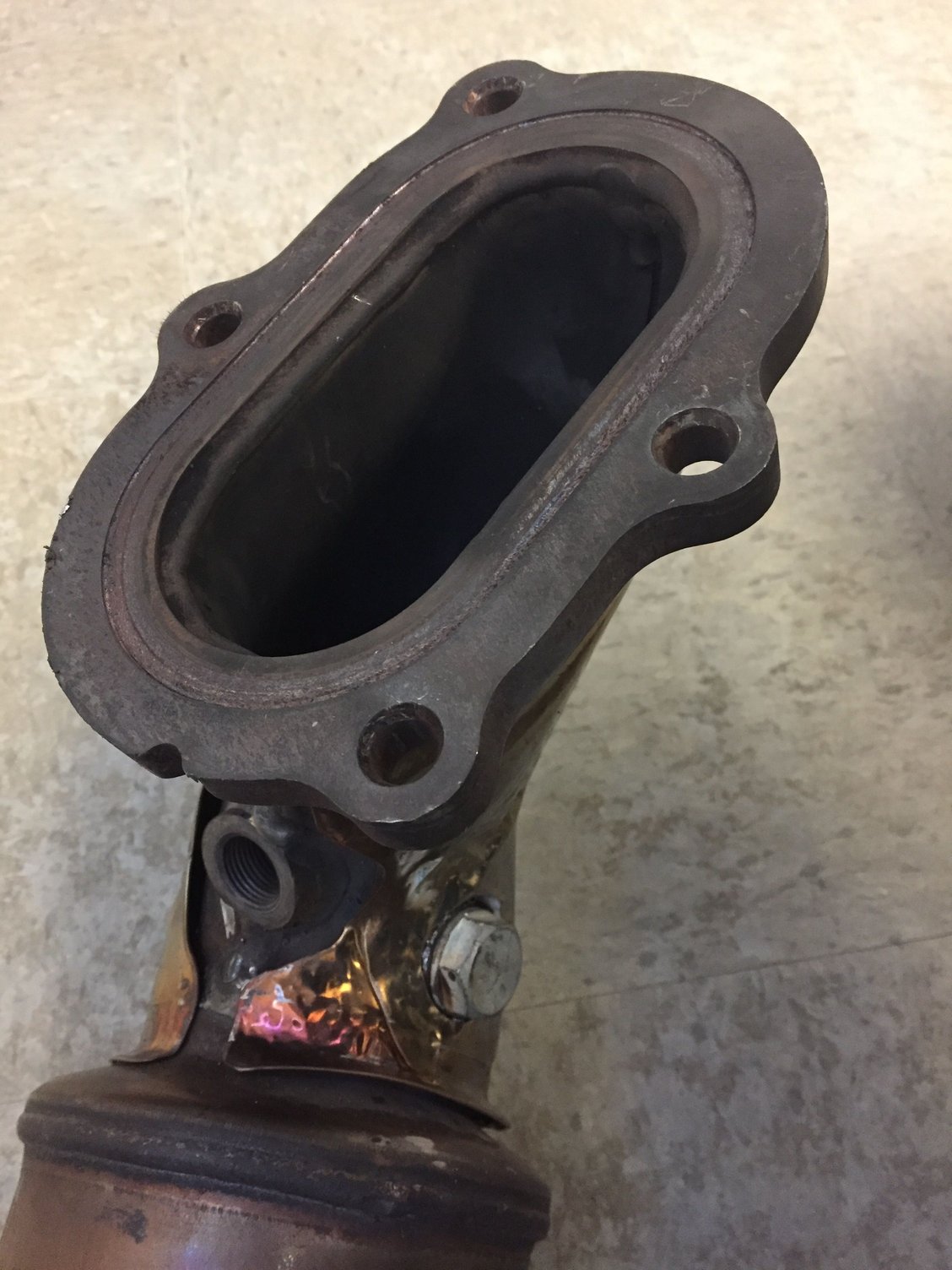

Sensor bung on the left is oem, bung on the right (with plug) is the one I added.
It's just a dyno session, not a tune session on a dyno...at least that's how I read the OP.
In this case, they are going to pick the easy path and use the tailpipe sensor because it's easy and quick.. that's what happened to me on my previous dyno sessions and it's human nature.
What I was saying is that you should request (and pay extra if needed) for them to install a wide band (in the left front sensor bung pre-cat) to be sure and get the most accurate readings possible. I say this because your main stated reason for the dyno is to determine if you have a safe AFR or not... so why not be as accurate as possible in measuring your AFR?
I am actually installing an extra wideband O2 sensor bung on my lead pipe for a full time wide band gauge.
