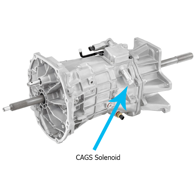

Any chance you knocked a connector off the trans, or interrupted something underhood? Did it start at the same time as when you installed your throttle body?
Here's a pick of the trans, showing where the solenoid is. There are a number of harnesses that could be loose back here.
I would think your worst case in the event of a failure would be that it always forced you from 1st to 4th, wrecking your track day. But it'd still be driveable.

That does appear to be the issue. Fortunately the car is sitting on the lift right now so I was able to go out and take a look. The harness is pretty crispy and feels very much ruined.
