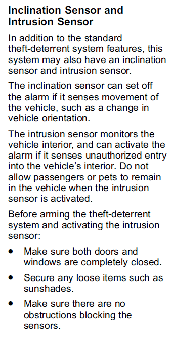

Default Intrusion sensor disable switch..
don't think kneeing the switch while driving would activate the alarm, if anything it would disable the alarm. However in order to disable the alarm the Beast needs to be turned off. That switch will disable both the Inclination and the Intrusion sensor's...

I would imagine the default setting is ON and he bumped the button. I suspect the message was likely "Motion Sensor Disabled", not "motion sensor detected". A second press turns it back on.
My convertible has this button, but I was told there is no interior motion detector.
My guess is that this button is overloaded, and is used for the "tow away" sensor, which the convertible does have. Anyone know?

The convertibles have both sensors and I've tested them both
Easy to test if you want to, go sit in the car and have someone walk away with the fob, or have someone lock the doors with the fob while you're sitting in it.. wait until the red indicator light on the dash starts a slow flash and then move a little..
