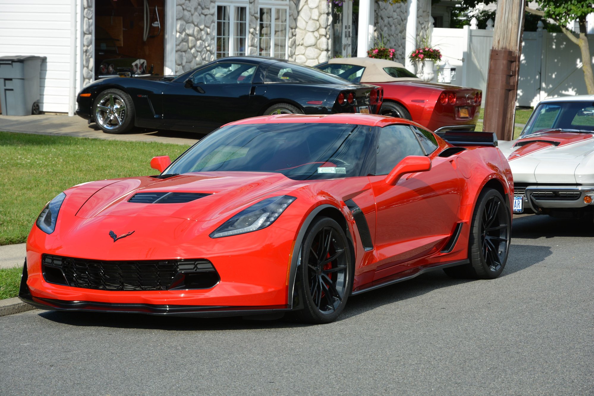

I use https://acscomposite.com/collections...-z05-2015-2016
great product and easy install, mention me from the forum bet you get a better price.
I have their front splitter, side rockers and rear spoiler
There stuff is exactly same specs as OEM GM
