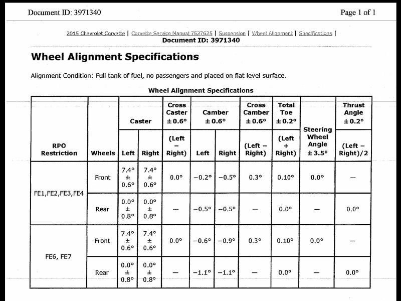

The factory specs on almost all cars are as wide as barn doors. You take the car into any shop and ask them to check the alignment and they can tell you it is within spec even though the car is pulling to one side or the other. That is the Green and Go check up.
Look at the huge tolerance variation you get from the factory alignment specs shown below.
The C7 doesn't come with a track alignment as the track alignment is more severe than the max specs shown here. However, the base alignment used by the factory does provide snappy handling on the streets and highways. As for the camber causing the wear it is more than likely the toe may have been toed out a little too far for the amount of negative camber the wheels had. Notice the toe is supposed to be +.1 degrees but the tolerance is + or - .2 degrees that means you could have -.1 degrees of toe out and still be in spec. Combine that with the max camber set at -1.2 for the left and -1.5 for the right and you get the setup for inner tire wear with the alignment in spec. Green and go don't look at the numbers and think about what they might mean.

Took it to an alignment shop that has lots of experience with Vette's, Ferrari's, etc. We found that it left the factory with the negative front camber far exceeding the specified settings. Left was -1.7 and right was -1.6.
Replaced tires (Tire Rack) and set the front camber to left (-0.6) and right (-0.7). Now 5,000 miles later the fronts are wearing evenly and the car drives much better on the street. It tracks straighter and doesn't hunt left/right with every little ripple in the road.
