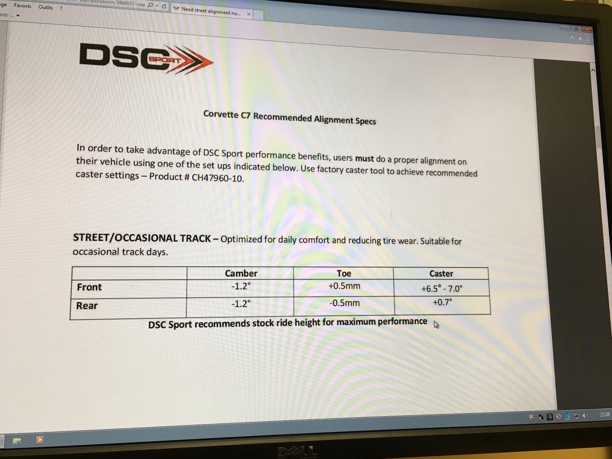

I have given these specs to my shop to do an alignment on my 2017 with 4000km. The OEM specs was so off...
Is it a good set-up for a street driven car with a lot of spirited driving and a lot of curves.
I will post my alignment specs sheet later.

I had exactly this done to mine and was really surprised at how much difference it made...go for it.

Looks good - but rear caster spec is conspicuously missing!!
You can see at the top of the monitor that this was done at TPC racing. The rear caster spec is done manually and I'm confident that Levitas made sure this was done right.

you need the special tools for the caster.
My shop buy it to do my alignment.
LOL. I'm pretty confident TPC racing has the 'special tools'.
