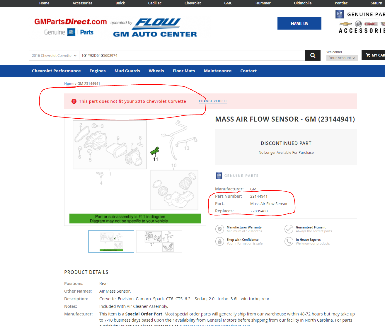

Just got my MAF sensor replaced afetr repetitive P1101 error.
I noticed that on my 2016 Z06, original sensor p/n was 23144941.
New one provided is 22895480, but when looking at AC Delco site recommended p/n is 23262344...
Is there anyone able to clarify since I am a little bit confused on which reference is correct and if the 22895480 received is suitable for our car?
Thanks

5480 is listed as 2014/2015
2344 is listed as 2016/2017
4941 is the old version of 5480

it will fit your car, they are all the same. they probably just made a running change in 15 and then made it a new part number for the 16s.

Many thanks! I was worried since I noticed that all sites are saying that reference will not fit my car...
e.g.
2014 thr 18 are the same
