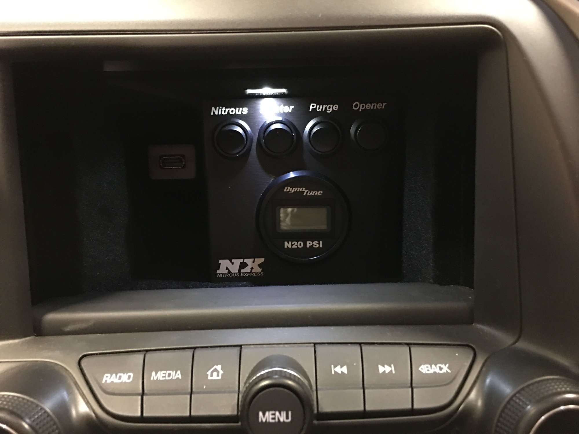

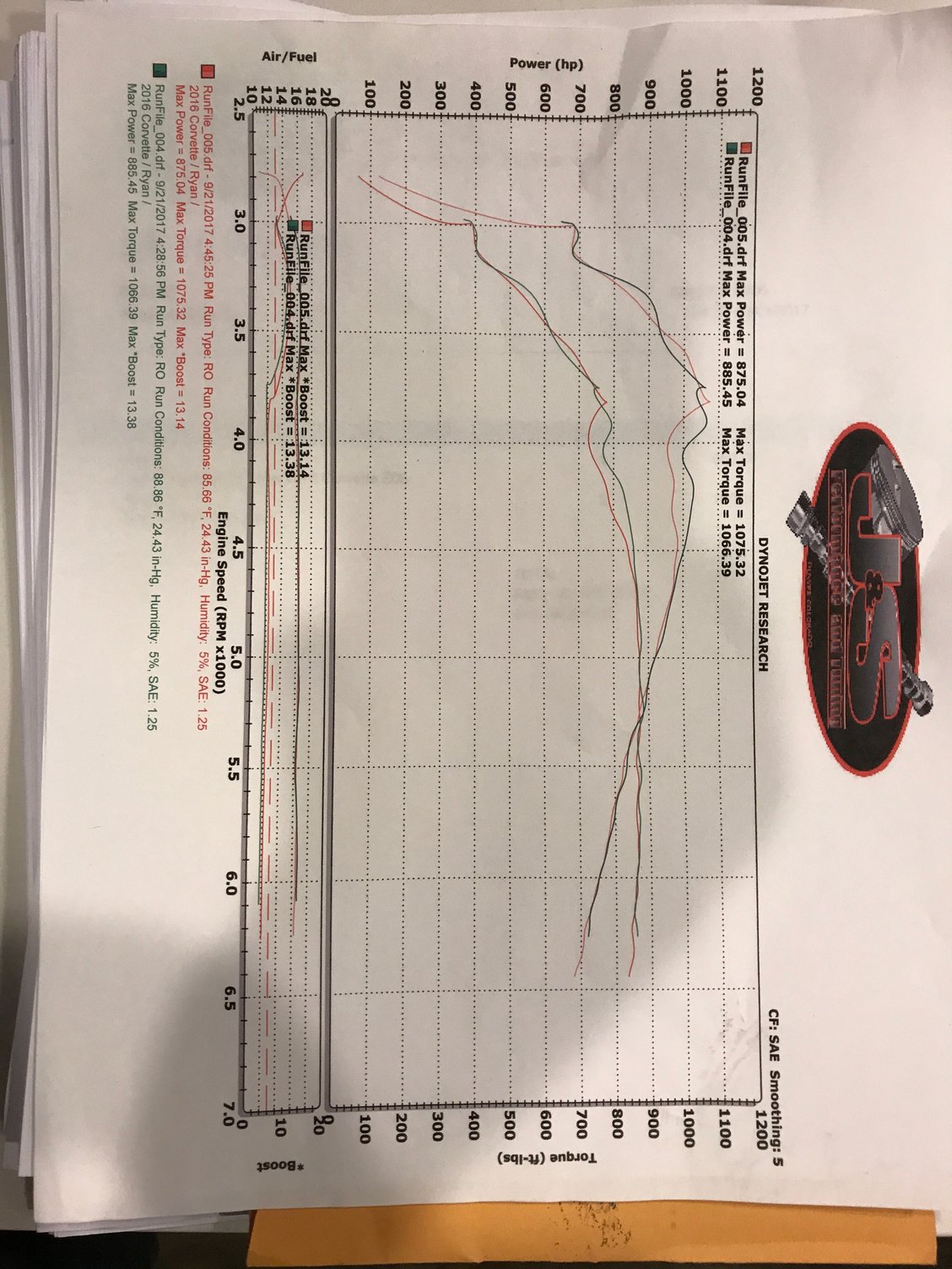

Had a chance to do a few pull on the dyno today. Man does it rip!
Mods: stainless works headers, CAI, 18# lower, and 150shot. Just tried a 3rd gear pull around 50mph and it took off! Super happy with the setup.
885whp
1075tq

So, you are getting away with a 18% pulley with no Meth or E85 on 93 octane?
Did you dyno the car without the nitrous and if so what HP did it make?

I can get away with it because I'm in Denver at 5,280' elevation. Off spray it dynod at 600whp 713tq

On the spray I have stand alone c16 fuel that enriches the shot.
