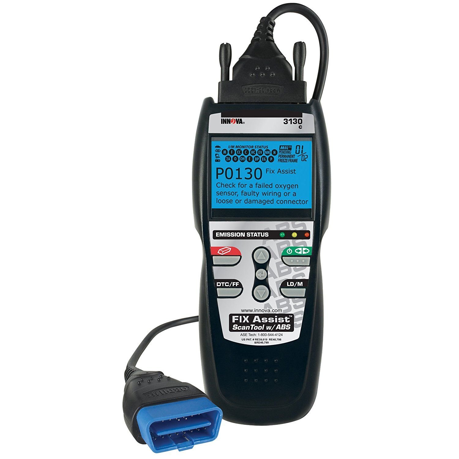

Do an internet search for "OBD II code scanner" and you'll find a zillion places from eBay and Amazon, to just about every auto parts store, to Walmart, and Home Depot.
You'll find prices from less than $20 to several hundred $$$ at different places and for different features.
You want an OBD II CAN capable scanner. Most do not read ABS codes, but Harbor Freight has one for $140 that will read ABS diagnostic codes.
Here's what one looks like - I think I got that picture from a Walmart site. You can see it has a plug you connect to the OBD II port:

I bought my Innova scanner via Amazon about 4 years ago when I was doing some diagnostic work on my 2006 GMC Sierra diesel equipped pickup and I have been happy with it. As BEZ06 noted there are a lot of different scanners available including those that work with smartphone apps but I wanted a decent dedicated unit that handled CAN bus, could read the separate transmission controller codes for the Allison transmission in my pickup, and could display live data frames.
Remember how you never used to always keep a jack and a spare in the car with you? Well with runflat tires on most vehicles that isn't a concern anymore but whichever vehicle goes on a trip WILL have the Innova with it. In 2016 my Z06 threw its first Range anti-AFM module induced code while on vacation in the Smoky mountains and I was able to quickly identify the reason and erase the code using the code reader. It is one of those tools you won't need often but it is very valuable when it is needed.
