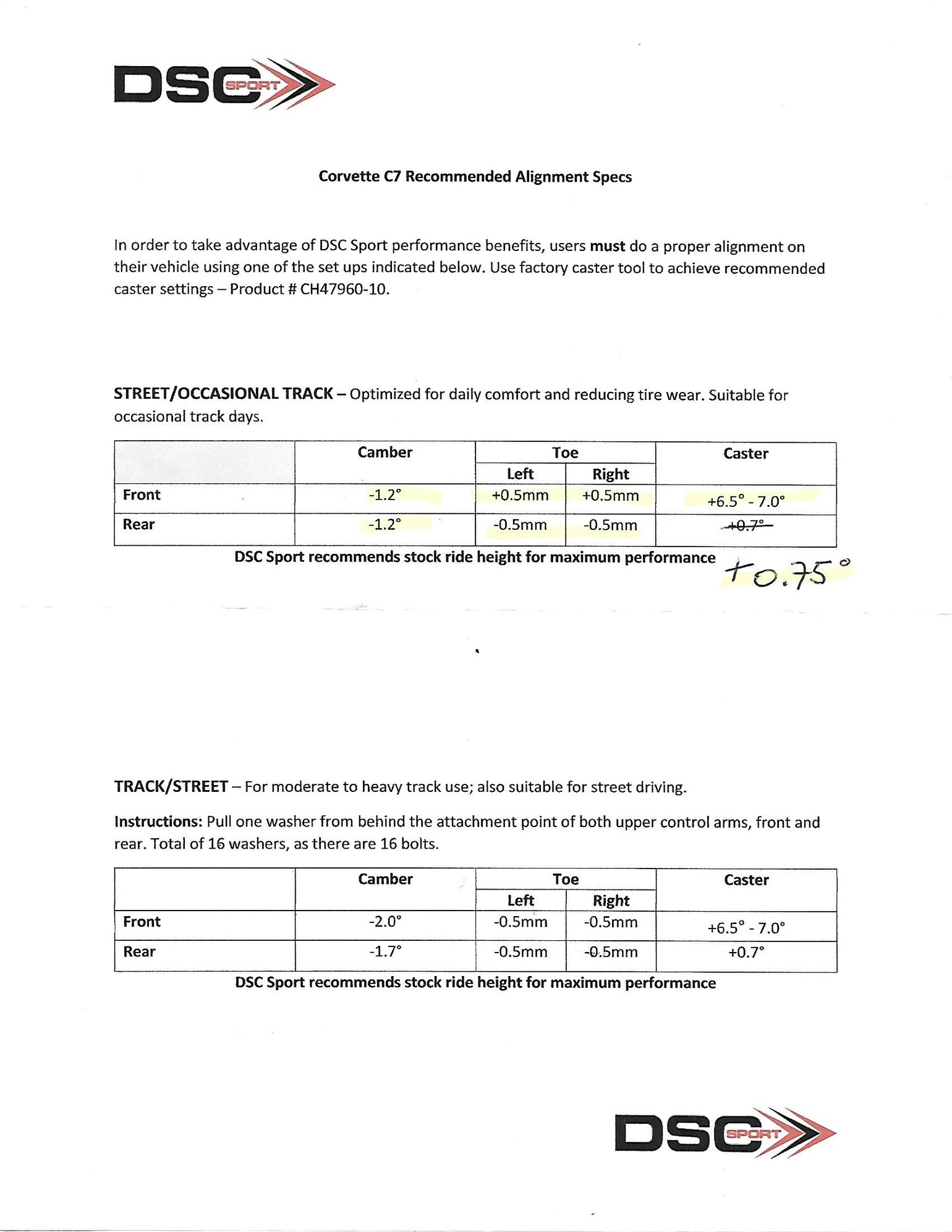

From: Raleigh NC
Your front toe #'s are different than what Mike provided me...
The numbers I have are +0.5mm L/F for front toe for his 'street/concessional track' setup.

Here are the DSC Spec's we used.

I just emailed Mike; looks like they may have updated their recommendations.
This is what I went off of...

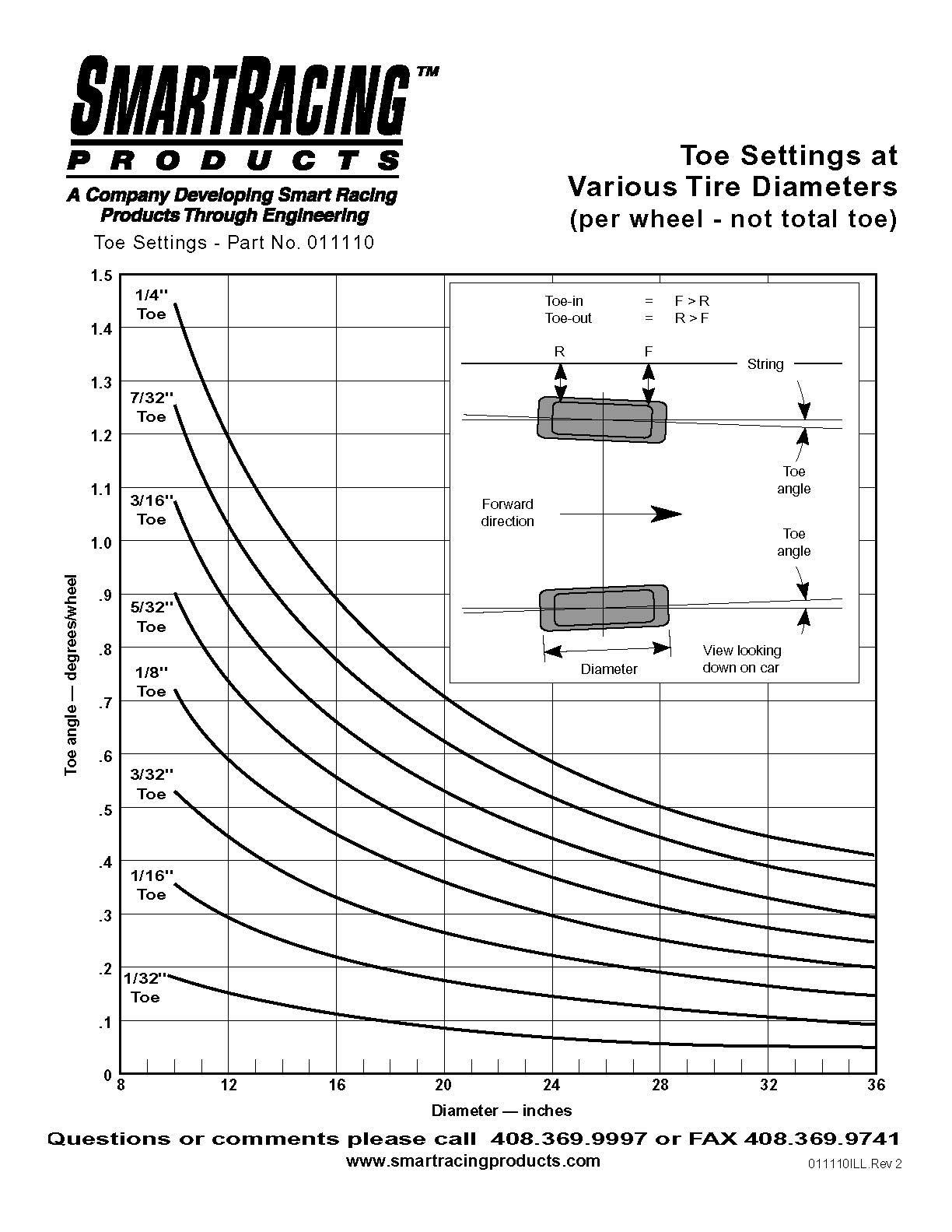

His toe numbers are in degrees Vs Mike's numbers in mm. You would need to know the distance across the tire (in mm) that Mike is using to determine what that means in degrees. If I remember my Trig correctly degrees equals ArcTan of .05mm/xx.x mm.
Degrees is the most accurate method of specifying toe. Using measures of distance such as inches or mm depends on how large the wheel is. A .05 measurement across a 10 ft diameter wheel is a hell of a lot smaller angle than a .05 measurement across a 2 ft diameter wheel. However, distance is a lot easier to measure in a lot of cases. When I do the alignment at home I am using two tape measures separated by 24 inches that have increments of 1/64 on one edge and 1/32 on the other edge. 0.05 mm is about 3/128 in inches but I don't know if it is across 24 inches like mine is. Since I can't read the tape measures that accurately (parallax and poor eye sight come into play)
I just settle on increments of 1/32. As you can see in the following chart degree readings that are in the 0.05 range are very small and very hard to measure across a 20 inch tire or a 24 inch separation on some toe plates.
Bill

I find alignment degrees/mm converters to be quite useful. Many available. Here's one:
https://robrobinette.com/ConvertToeInchesToDegrees.htm
