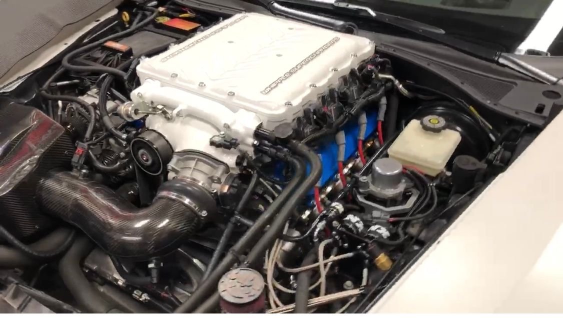

I have to say throughout this process they have been absolutely amazing! They provided tons of information, pros and cons of different build strategies, shipped me great parts, helped guide through the build process (even though I am out of state and they aren't doing the labor). Their communication, enthusiasm, professionalism is all second to none. On top of that their tuner Brian has been extremely helpful and dialed in my complex setup remotely and flawlessly. Currently making 1000whp and 1200tq with 0 issues.

More info on the set up please. What power are you making boost only? What are you doing for fuel?

^^ I am definitely interested in that 2.9! What made you go that route over the procharger? I am about to make that dive myself. Sweet ride and I am also a fellow past SRT8 Jeep (x2) owner loved them Jeeps! Good to hear reviews like this.

I am in Denver so the elevation allows me to get away with some stuff that you might not be able to for a sea level application.

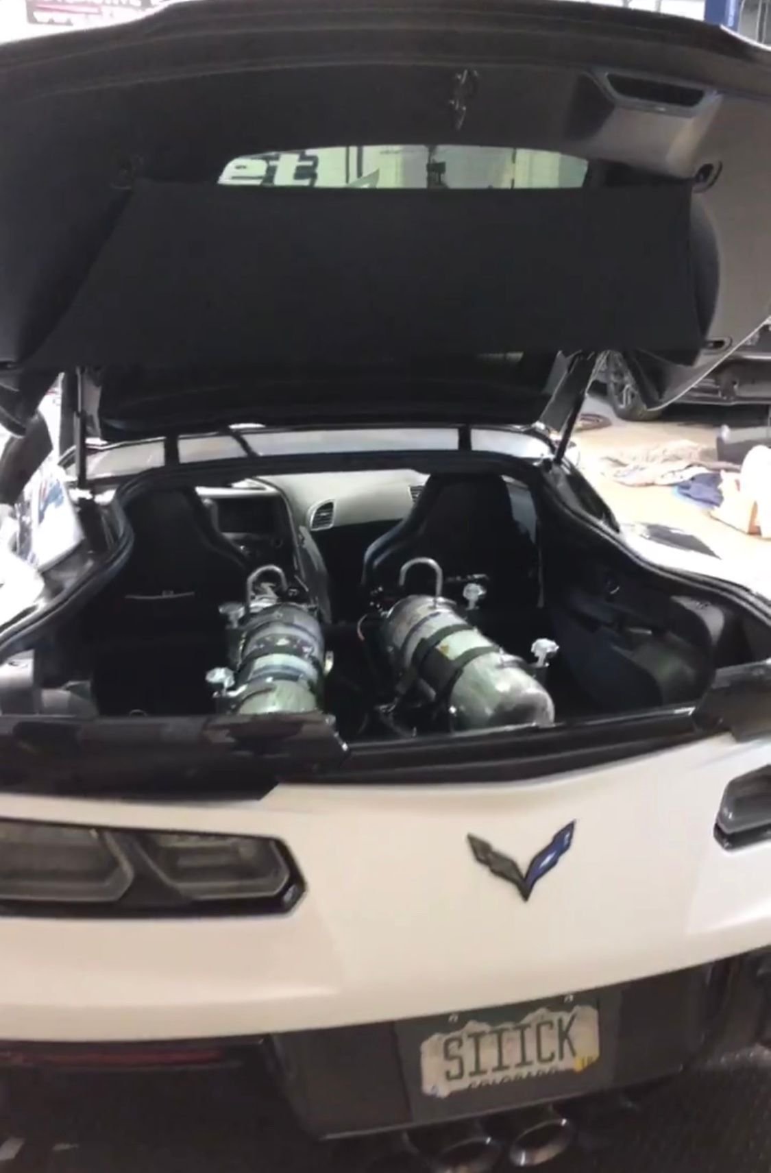

Car is making 750whp corrected for altitude on blower only. I have 18" lower and 3.25" upper but I am still on 91 pump gas. That is the main reason I went nitrous is that it was an easy way to get more fuel and air into the motor to make up for the 7000+ DA.
Just personal preference mostly. I have always liked PD blowers, love how hard they hit at a lower RPM. Also love the whine vs the chattery metal sound.
Originally Posted by saleen556
Great to hear. I'm considering doing the 2.9 as well in the future. Just not sure I want to deal with the headaches that come with modding to that extent.
The only hard part about the whipple/nitrous combo is dialing in the tune, but as I stated above, Brian at Weapon X is a master as his trade and was able to remote dial me in. Was pretty cool to see actually. I was doing passes at the track with HP Tuners plugged in and it was connected to the hotspot on my phone. He was able to see live what was happening, adjust the tune, etc...

Doy you have anything else for fuel besides the nitrous? Cam? Meth?

No stock CAM and no Meth

Thats pretty killer that it made 750 on the stock fuel system!

I can get away with it because my dyno numbers are corrected by 20-25% for the altitude. If I was to bring the car to sea level i don’t think the stock fueling would hold. On an 18%lower and 3.25” upper I’m only making 15lbs of boost. That’s like a 19lb combo at sea level.
