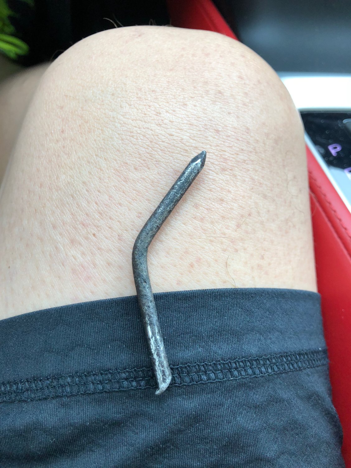

Framing nail from new construction. Through the tire and bent on the rim. $640 Nail.
