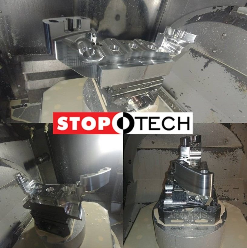

Our StopTech STR Kit will be available in a few weeks, it will be a hair less than the AP kit but replacement rotors will be approx 350 each versus 600. They are going on our car that is headed to the Nurburgring so performance is definitely there.
Give us a call for more info. 972-429-1963
