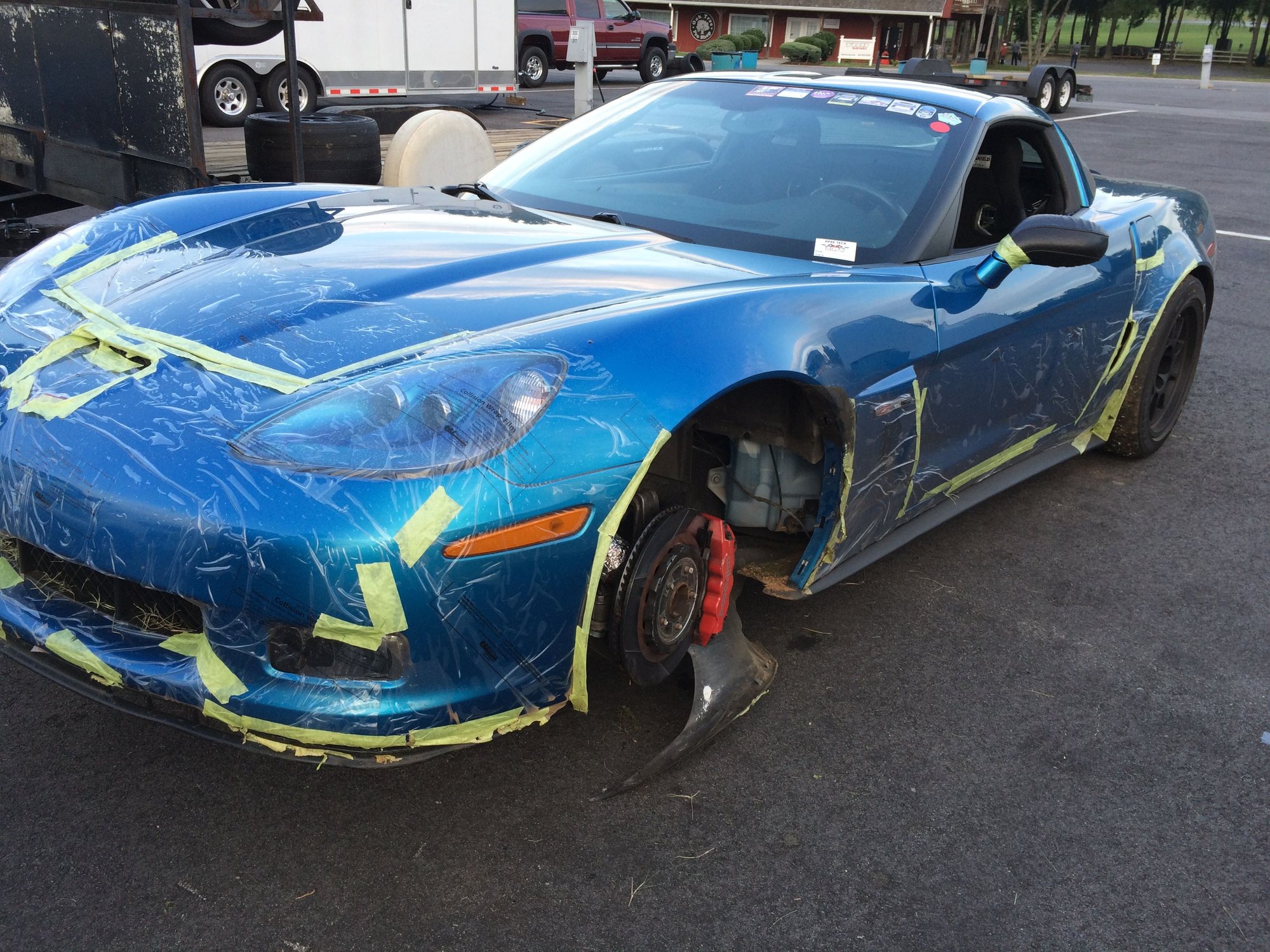

If you mean something like Expel it isn't. I believe Expel is 8 mils thick while this is 3 mils. However, Expel is meant to stay on the car for years while this stuff is for temporary use while a car is being transported or stored outside. I used to do a 10 day stint where I would run 8 track days over the 10 days. The collision wrap worked great over that time period and saved the front and sides of my C6Z.
This is a picture I took of my C6Z right after I lost the left front wheel in T1 at VIR at the NCM even in 2015. The fender was ruined and couldn't be repaired due to the wheel breaking it as it came out of the wheel well. However, the Collision Wrap held the fender together and I didn't realize the damage was as bad as it was until we removed the wrap and the fender pieces started flopping all over the place. It works pretty well.
Bill
