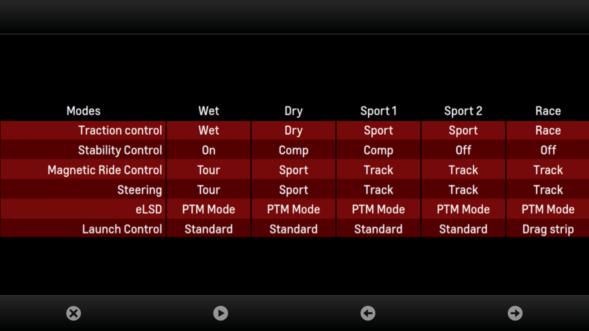

NO!!!! Pushing the button after you are in Race Mode takes you out of Race Mode and to an unknown condition. The selector is in Track Mode but there is no definition of what that does without choosing one of the five drop down selections.
In Race Mode there is no TC (as it is commonly known) and no stability control. However, there is Performance Traction Management which helps corner exit.
In Sport 2 Mode there is no TC and there is no stability control and but you have PTM and a dampened response to throttle inputs.
In Sport 1 Mode there is no TC and there is a stability control function similar to competition mode. You still have PTM and the dampened throttle response.
Dampened throttle response doesn't mean you don't get full power. It means it doesn't happen as quickly which helps reduce incidents because some people move the throttle up and down too quickly.

John: just turn the dial until it shows Track; press down once and the various modes will be displayed, including Sport 1; Sport 2; Race, etc. Rotate the dial clockwise iirc until Race is showing. Then let go of the dial and do NOT press anything on the controller. At this point in time you will be in 'Race' mode with ESC and TC off, but with PTM still active.
Bish
Bish,
He has to press twice to get the sub menus. Sometimes the car will seem to have a mind of its own and won't respond right away but generally it will drop down to the sub menus right after the second push.

Old Jun 30, 2018 | 02:28 PM

Sorry Bill I forgot it was twice. The really important thing though is not NOT push down at all once the DIC is showing Race, etc.

OP - if what you're wanting to do is a drag strip launch, don't bother with the PTM sub menus at all. Just push the button down for 10 seconds or so and shut off TC and AH, and let 'er rip. You can do that in basic tour, sport or track settings.
