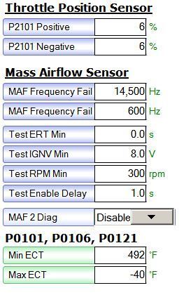

If you know someone with an HP Tuner it's as simple as changing stock values to this in the green boxes.

8850 is correct.

Mine did it every time I went west of the Mississippi river and I just used my HP Tuner to move it to non-reporting.
