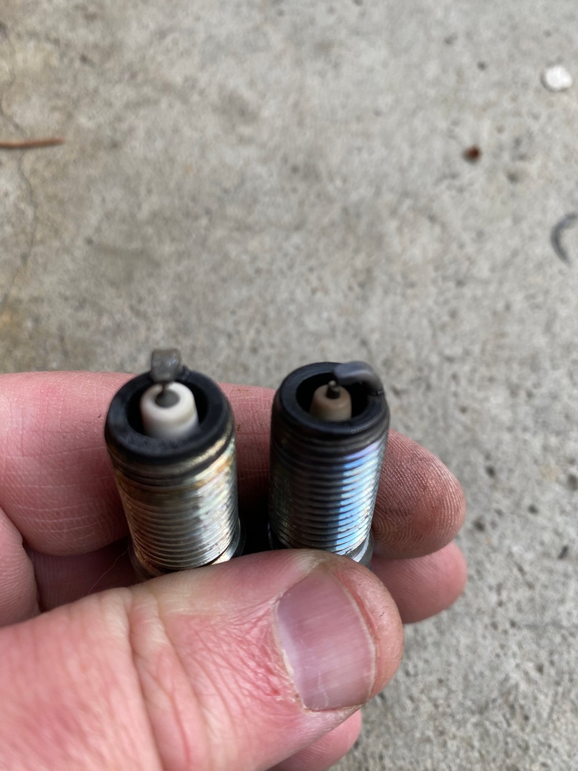

I decided to try the brisk plugs as well since I’m now running E85 and 14.5 psi on my z06. Here is a comparison of 300 miles on brisk vs a whole year on pump gas with NGK’s. I pulled them the other day to check on them because I started to notice some random loss of throttle response.

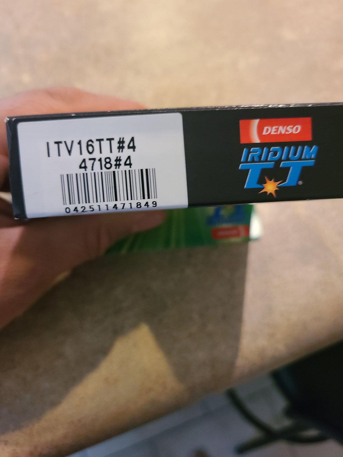

What's the DENSO LT5 part number?
I couldn't find the Zr1 plugs local.
So I just got the Z06 DENSO.
