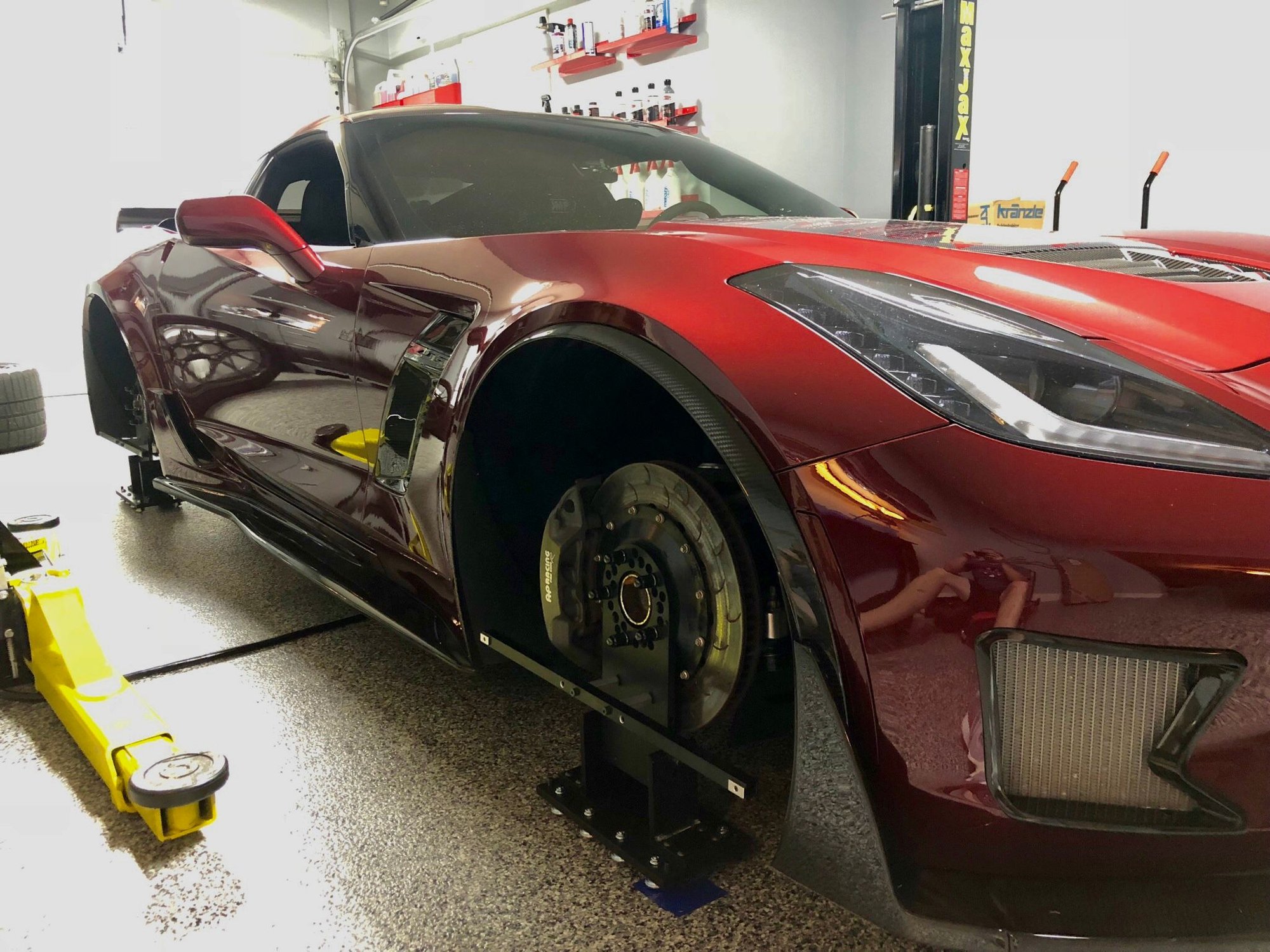

I got the bbx pro hub stands and scales and scale pads. I level the pads and do the alignment in my garage. I think Sean got some different hub stands but these work well. You can get the alignment exactly where you want it without having to have an alignment rack. I use a quickjack to raise and lower the car. I may get a lift at some point but right now just need the extra space in my garage.
Herman
I do have these, and they do work but the added effort is annoying when I want to make a quick change, or just confirm we are ready to roll before a race. Just a convenience thing at this point.

I think they're the same ones Sean got. I end up changing brakes every time I track the car so it doesn't cost me too much time this way. Once I get it set up it seems like it's easier than aligning it with the tires on.
