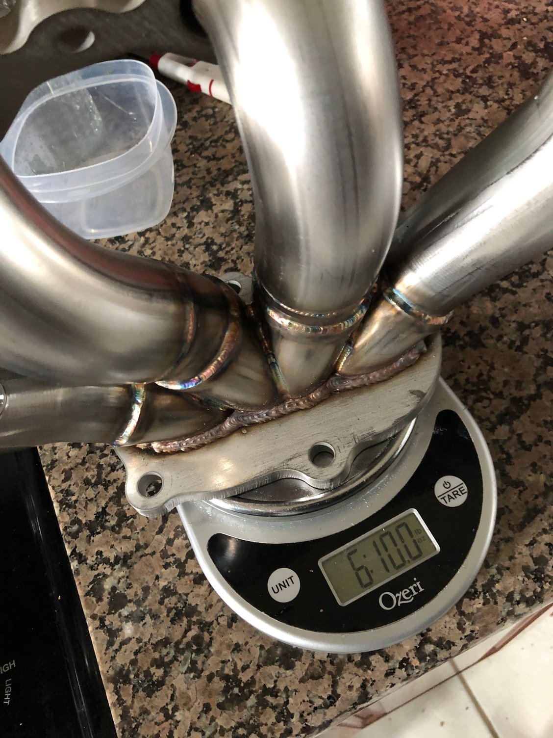

Get some weights and let us know if that 19 pounds difference is correct. Seems like quite a difference.

The 19lbs difference is for the cast iron exhaust. Here's the link from Holley https://www.holley.com/products/exha.../70301306-RHKR . It says up to 19 lbs so hopefully that's accurate. The z06 cast stainless exhaust is actually heavier than the cast iron manifolds.

I copied this from a post by Kracka
"LT1 vs. LT4 manifolds are identical in design and dimensions (including runner diameter and flow). There are only two differences to speak of:
1. Material (cast iron vs. cast stainless steel).
2. Weight. Although I knew the weights would differ, which one is lighter did surprise me! The cast iron LT1 manifold weighs 13.7 lbs while the cast stainless steel LT4 manifold weighs in at 17.8 lbs."
so these are 6.625 lbs each so isn’t that 22.35 lbs less on an lt4 and 14.15 less for the

Yep. Not sure where they got 19lbs. 22lbs is a good weight savings as long as you don't lose any durability. Not sure how much ceramic coating would change the weight but it wouldn't be much.
