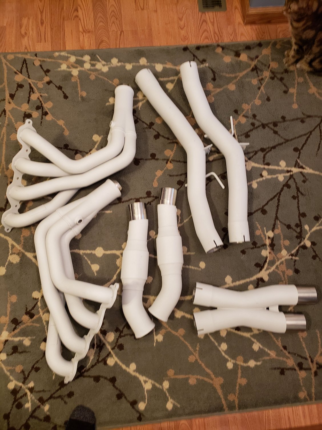

I used Swaintech, and it's amazing how cool they run.
Dang, those look nice.... how long did that color last?
It didnt, because I painted over it with Black high temp paint. LOL.
Swaintechs coating looks awesome initially, but it isnt meant to be cosmetic. Its purely functional and does an amazing job (significantly more so than spray on ceramics) Before accepting your order, they will tell you that the finish will mar and discolor easily, is porous and may grow crystal like structures etc etc.
Thats why I sprayed over it. Any time in the past that Ive used header paints, the paint finish will peel after a couple heat cycles. Ive also sprayed over jet hot that had dulled with similar results. This time? The header paint looks brand new. That in itself tells me the coating is working. You can grab a header pipe after only a few minutes of cool down and subjectively, the cabin tunnel is cooler as well. I paid about $800 to get everything you see coated. 3 week turnaround.
Theres another company in the UK called Zircotec that also has some badass coatings that can be ordered in an array of colors without some of the pitfalls of Swaintech. However, when I priced things out, they were over $2500 for the same parts.
