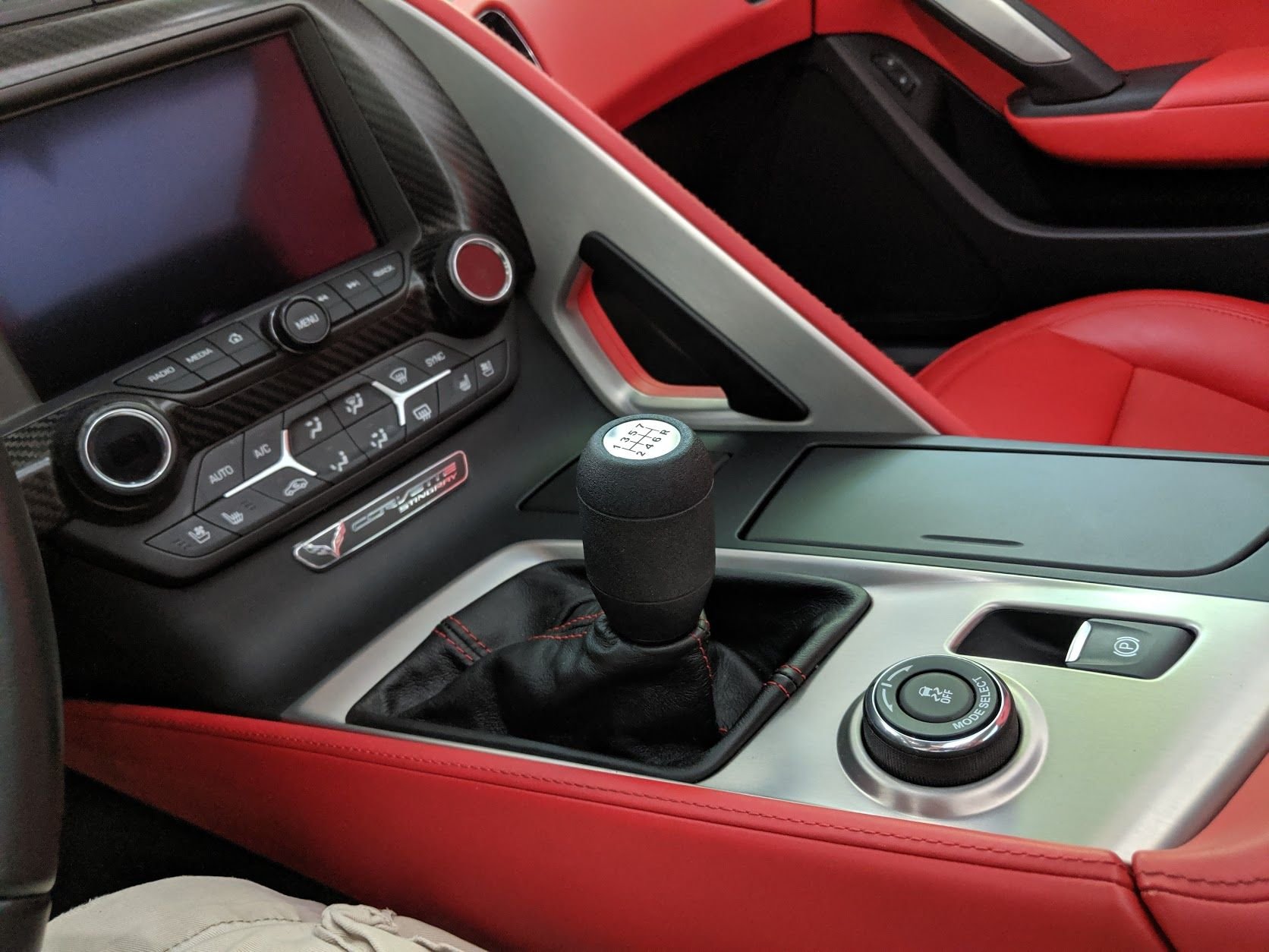

Hey guys, i have a 2016 z06 with the mgw shifter and when driven “full tilt” i cant quickly shift to 3rd without mis shift id say 3 out of 5 shifts. Im not saying its not me lol, but could it be because i misaligned the mgw shifter? A friend of mine had a c5 z06 and said he changed the tranny fluid and it helped alot him with the 2-3 shift. Just want to know if any forum members had this issue also. Car has 6k miles on it.

Highly unlikely it's the MGW shifter, I've installed 2 in my C7s. It does have to be aligned frt. to rear which is why they include an alignment tool. Missing the 2-3 shift is with HOW YOU perform it. You can't just shove it up & right to hit 3rd. You know the shift linkage has a "self centering" that is spring loaded to put the shifter in neutral directly below 3rd then straight up to 3rd. I suspect in trying to rush into 3rd, you are PUSHING it to the far right instead of letting the shifter find 3rd. As many have posted (hard core track folks) try palming it instead of grabbing it like like your .... Sorry, I'm assuming something here. Changing fluid wouldn't help this particular problem, it is normally done to help with the "notchy" or rough nibbling of gears that sometimes happens when the fluid is not warmed up yet. Don't know your background with manuals but practice helps unless you're damaging the gears by not hitting them properly or FULLY depressing the clutch trying to hurry the shift. Good luck.
Thanks, i have been driving manuals for about 20 years, learned to drive on one. I figured it was me just wanted to see if it was something i did in the install, im def ramming it in there like my older 911 lol

I know exactly what you're referring to. I drove a C6 Z06 (stock shifter) for 7 yrs before I switched to my C7. Starting the first day, I would miss 2 out 5 of my 2-3 shifts. Eventually got an MGW installed thru a buddy and he aligned it as others have mentioned above. No more 2-3 shift issues. I'd say get the linkage on the MGW re-aligned.
