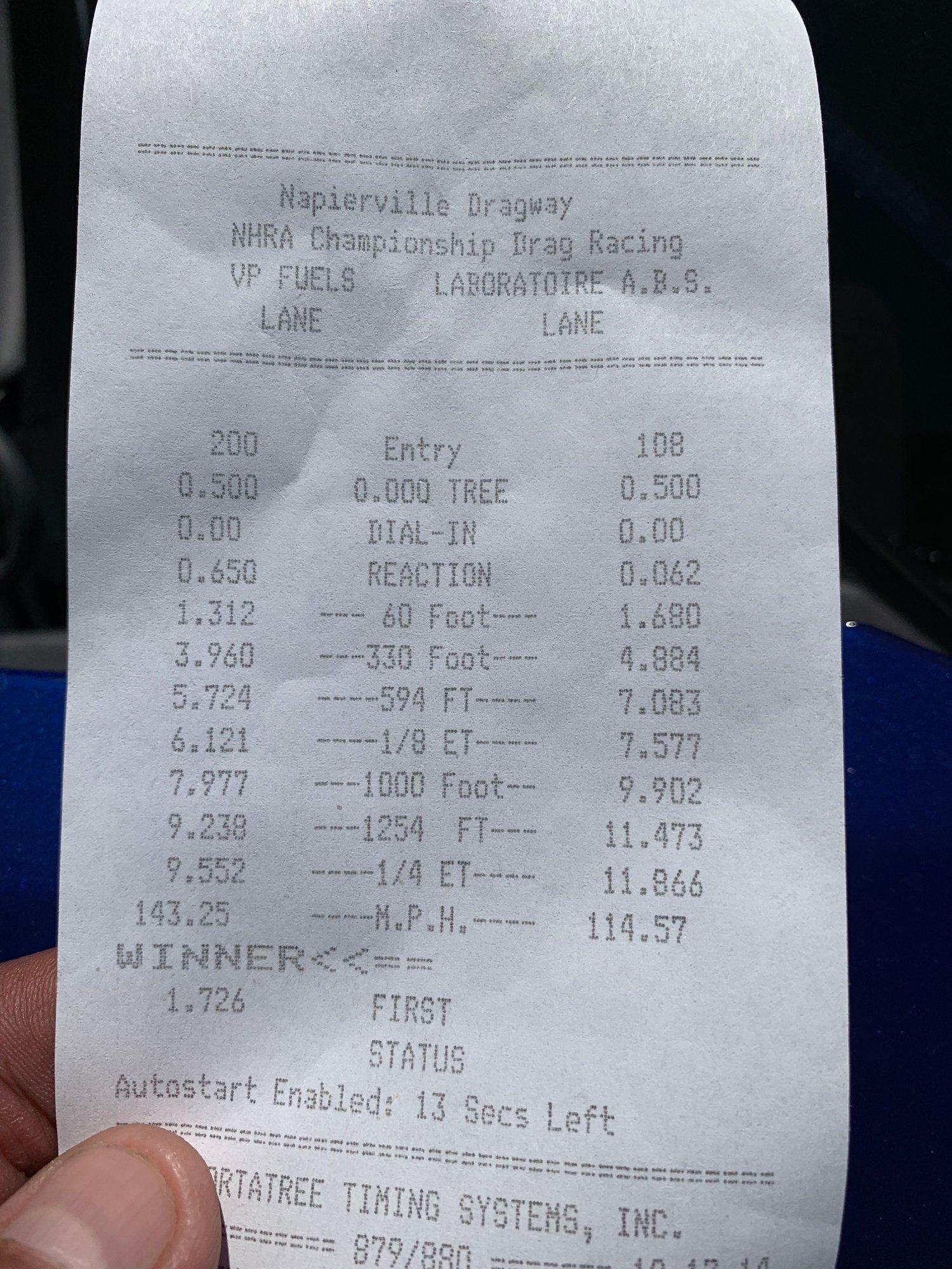

Off idle in sport mode, 1.31 sixty foots. Bolt on C7 Z.
Are you still on the stock rear end and half shafts? I assume this is a 15" rear tire? That is a killer 60' time! I'm just trying to get into the upper 9's without tearing the rear end apart. Then I will likely dial back the ethanol and be content in the deep 10's. Otherwise my local track is going to force me to install a roll cage, which I will not do to this car
Yes stock diff and shafts. 15" conversion as well.
Impressive!
