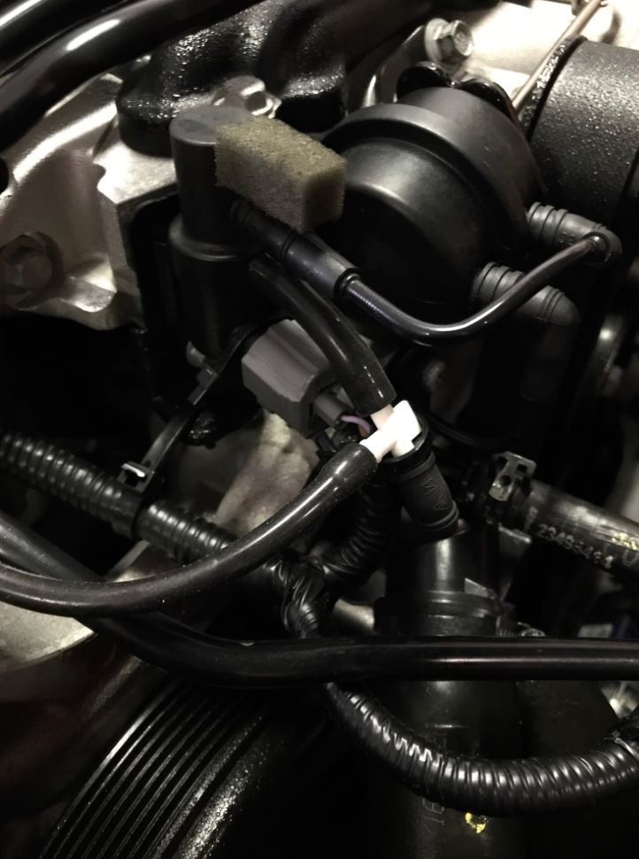

Here's where you want to tee into.

[QUOTE=8850;1600370859]Here's where you want to tee into.
[/QUOte
Yup that's exactly how i did mine. I used regular vacuum line. Did you use plastic tubing?

I used the flexible tubing that came with the kit and one short piece of vacuum hose. If I remember right the factory connection was a little to large for the kit tubing.
