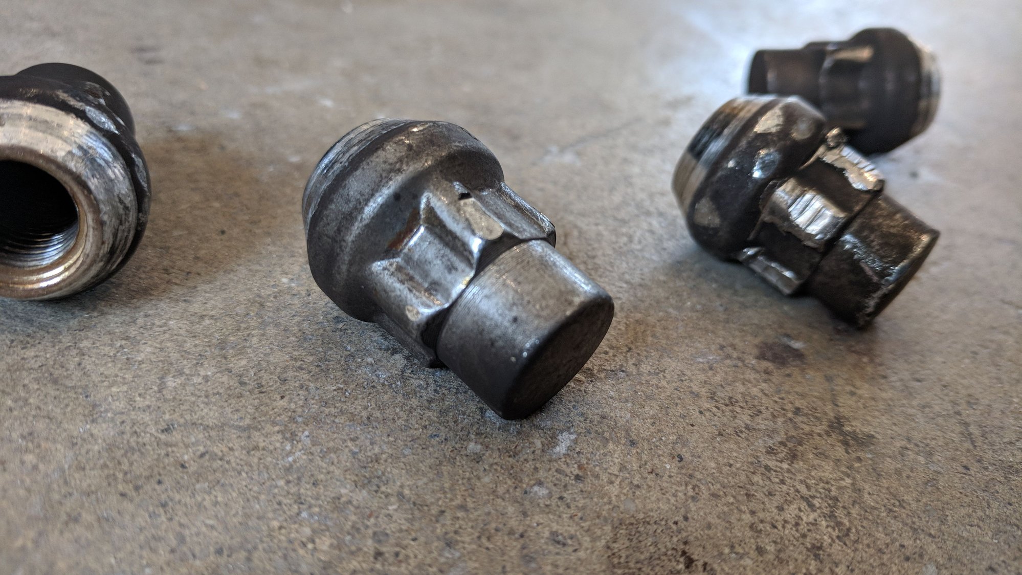

I'm an idiot and I lost the keyed socket to my locking lug nuts. Its rare for me to lose stuff but I did somehow.
Today I finally tried to get them off and 3 out of 4 came off with just a normal 6 point 3/4" socket! Lol
Of course, the last one fought me tho. It rounded off the edges and then the socket that I used for the other 3 no longer could grab. I tried bunch of different sockets and impact gun, just kept rounding it further down. Finally then was rounded down enough where I just pounded a 18mm socket on and that ended up working.
So long story short, im probably never going to buy locking lugs again.. it's a false security and didn't even slow me down except for the very last one was unlucky.
I'm sure there are better ones out now than these but to me it's just not worth the hassle

They are a deterrent since most thieves aren’t going to spend the time you did to steal them. It’s a 2 minute job for thieves.

My point was 3 out of 4 came off with a completely normal socket....

thieves wouldn’t want to “hammer on” sockets. Too much noise.

One out of 4 required hammering on.. the other 3 came off as a normal lug nut with a slightly oversized socket. That's my entire point...
If I was lucky.. the 4th one would have came off just like the other 3
