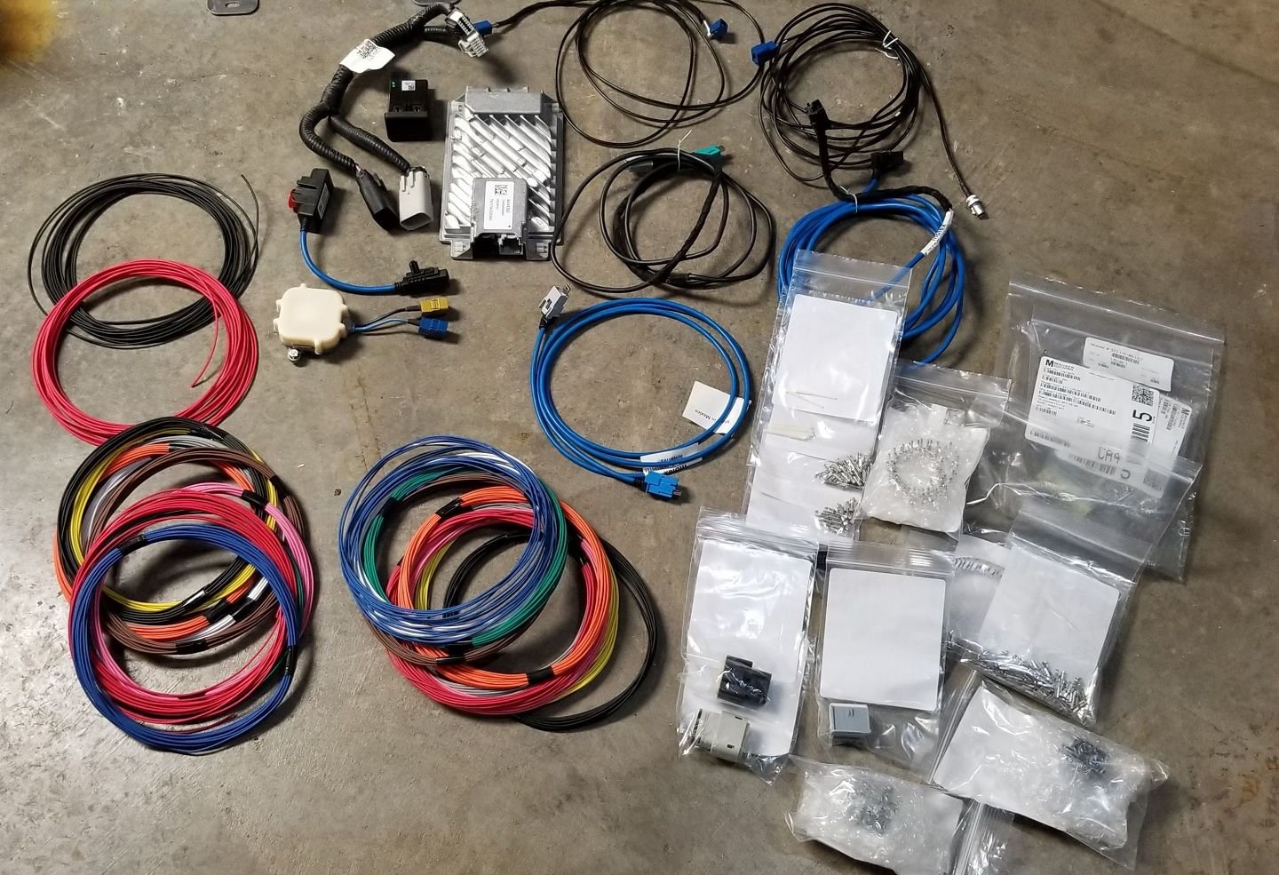

Found this....can I adapt it to my 2019 non Z06?

I think there are other parts required including the camera and the harnesses connecting it to the recorder. Probably several other things that are necessary including reprogramming the center display so the PDR can be set up and turned on.

GM doesn't support modding the cars, so that's his official line. I've got a PDR installed and working in my 2014 Z51. You need a lot more than just the module and the camera. One of these days I'll get around to doing a write up on the install.

No. It most definitely is not

Realistically, you're right. I only did it because I like projects like that.

Name one that captures the same data and writes the telemetry, video and audio to a single storage location, while not having cords and suction cups everywhere.
The GM PDR has access to data parameters that are simply not available via generic OBD2 protocol. I don't know of anything that captures the GM proprietary data.
