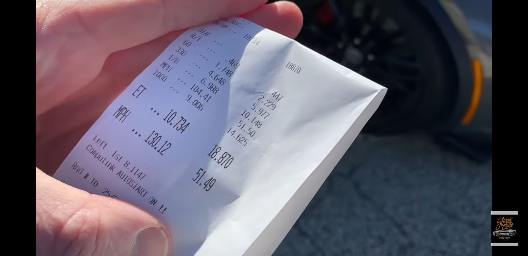

A8 for the win... I respect you guys trying to drag race the manuals but it really is futile when any 2015 A8 bone stock down to the air box and tires can put these numbers down..

Haha, yeah yeah I know! I have a turbo Camaro with a th400 and a transbrake for the auto stuff. I enjoy banging gears, I know it will never be as fast and I've made peace with that
