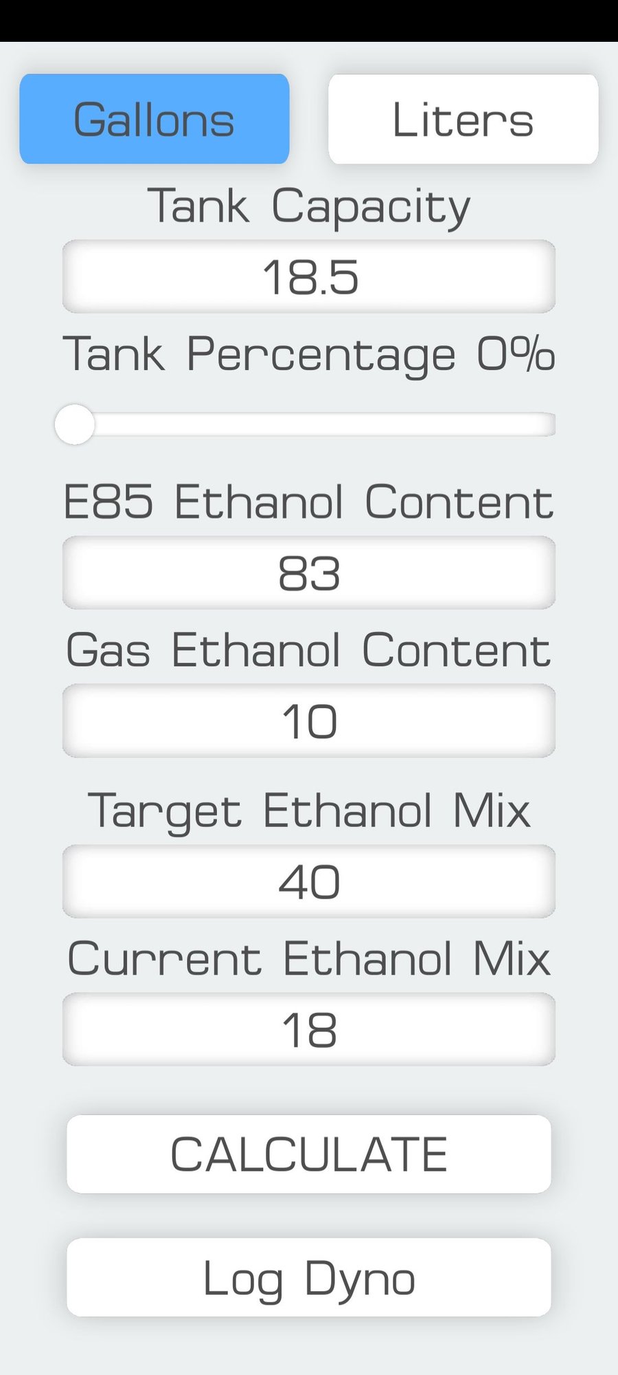

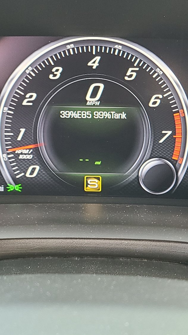

Hey Mike. Step 1, you need to install a flex sensor. Several kits out there, I used DSX. Step 2, you need to program ECM to enable flex and tune for it.
I am mixing in the tank. I have a dash logic which will show e percentage and tank percentage on the dash. I then use an app called E85 blend (Android) to calculate how many gallons of 93 and e85 I need to keep the mixture correct. After filling, It takes under 5 min for it to slosh around enough to mix and get a consistent reading of the e mixture which is typically about 1 to 2 percent of what I was aiming for

My dash logic shows fuel tank level in percentage, so no guessing on fuel levels

So is the dash logic piece the DashControl OBDII Display Controller by Auto Meter? Just under $300 it seems. Do you just plug it into your OBDII port right before you refuel to determine what quantities of each fuel to mix and then unplug it? Or is it permanently attached to the OBDII port?

Correct, thats the unit. Originally made by Palmer Performance, but I believe they sold out the design to AutoMeter. It only works on 2014-2016 models, so if youre newer than that will need to do something else, HP tuners N gauge maybe.
I leave mine plugged into the OBD2 port all the time, but it can be removed simply by unplugging just like you would a scan tool. It basically hijacks the navigation section of the instrument cluster and displays information there. If you dont want to look at it, then all the other pages still work (speed, built in factory gauges etc)
