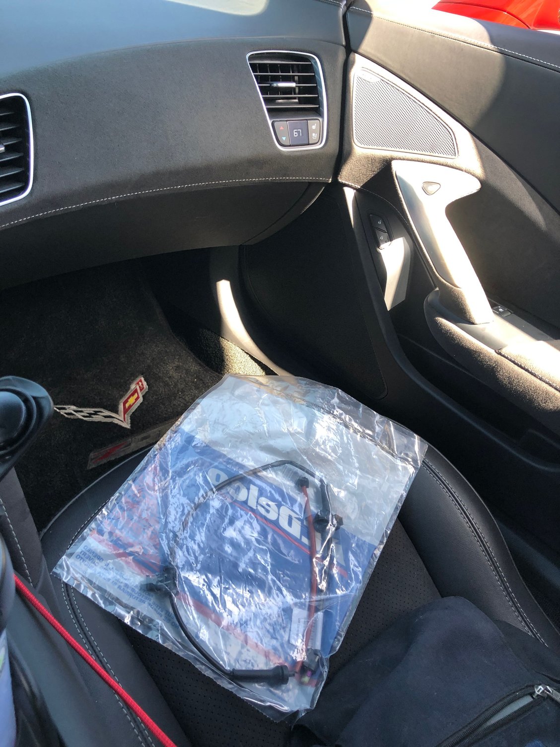

Same hurrr..
16z 07 -10k miles Clean and Super Sexxy!
Have an Appt today at Noon to replace Brake wear sens. Dealer did part for me for $52 out door 🙄Watev 2nd One i Replaced so far!
0 Track time but i do beat the Dawgshit outta her , this one came on last Fri eve when hangin w 2 800+ Hp cars doing a lot of Hi Hi speed Runs for a good amount of time! I Suspect the heat from Ceramics , And S Florida temps that nite was 82d just broke it! Last time the Mech.. told me they get so hot and dry out that then eventually (in a short period of time) become brittle and fall apart
Altho i must say someone said that if not tracked the Ceramicss will last a lifetime , i beg to Differ. As stated i use and beat my Ceramics on Street and Highway and w a look at pads thru rims im def chewing threw pad thickness! My are down i’d say a good 50%!
Ima Have him Ck the insides of pads today as well and ck for any premature wear or issues as from outside they look Great but they say (Everyone on forum that i’ve read about ceramic threads and sensors) have to look inside calipers as well! Last thing any us want is a Dead Pad make contact w the Rotor 😯🤬 That’ll cost a good Chunk o change not to mention maybe almost kill someone. Better to be safe than Sorry w the brake Sensor Msg!!

I'm handy and do remove the wheels Quite often to clean Calipers and Wheel barrels but idk w this, i had just stopped by my mech and he was like sure w the lift is a lot easier + its like 92d Hawt as ***** so just said F it and let him do!
So it turned out to be the be the Pass side this time , a few mo's ago was the driver side! As he pulled it out the Caliper it literally fell apart was Extremely Brittle and the wires were Frayed cause a loss in the Loop triggering the light!
Ck'd both the fronts and the Pads look great , almost same from looking thru the rim as using the lift to ck pads on lower inside! I watched him do and ck both Sensors and routing of the wires and its a VERY SIMPLE Process.. Hopefully not but if there issa next time i'll do garage for sure.
Light Gone , Ahhh
