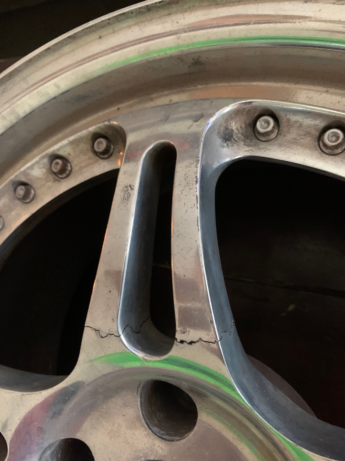

Fully forged wheels are not perfect either. They are definitely the strongest option but don’t think because you spend $ means they’re infallible. We have very low profile tires with wide barrels, and a reinforced sidewall to make the tire a runflat. All of these contribute to the stresses our wheels see.
Here’s a fully forged, American made wheel that I had on another car of mine. The barrel of the wheel wasn’t bent. I found the crack when polishing the wheel.

I am saying I have not seen real forged wheels advertised anywhere for less than $4k for a set. There may be, I just have not seen them.. The options I have seen for less are the spun wheels. I paid $5400 for a set of 4 Forgelines. I also never said forged wheels cannot be broken...simply that they are the strongest alloy wheels you can buy. And Fat, it looks like your failure is a manufacturing flaw...which can happen. If it happened within a reasonable amount of time (like a couple years), most reputable manufacturers will make good on it. Since it loosk like a modular wheel, there is always a chance they were mis-assembled at some point, which could still be manufacturing if you have never split them yourself.

No, I didn’t split them. They’re older, and this manufacturer had this happen more than once. But I’m getting way off topic.
