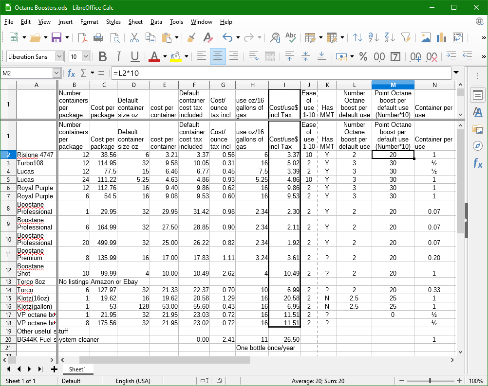

My research into octane boosters was revealing to me. All the boosters on the sheet below promise to convert 91 octane to at least 93 by either pouring in a bottle or mixing as shown. I was somewhat surprised to find such wide price variations to achieve my result. Thank you to all who suggested the various brands. Quantities are for filling up with 16 gallons. "Ease of use" is my subjective rating.
NB: My tax rate for column F is 4.49%.
NB2: Only additives promising full AKI number increases listed. Some products not listed raise octane a few "points", one tenth an AKI number. The advertising is most confusing, sometimes producing zero useful octane increase output when run thru my BS filter. Thanks to companies' tech support, and one company president, who answered my queries.
NB3: We've only used one of the listed products so far, Lucas. My purpose is to uncover cost and how much to use for 2-3 AKI points amongst products all promising a similar result. We're into winter here as of yesterday's snow so likely no more testing til spring.

...but what they don't show you, are the orange valves, plugs and pistons!!!! Lol

I'm not sure that that is a bad thing per-se. I usually don't do additives, but back when I was racing turbo Buick's, late 1980's, a bottle of STP Super fuel injector cleaner could save an otherwise toasted o2 sensor. I used leaded race gas in those cars, no problem with cat conv as I got rid of it almost immediately. And they still had to be replaced at one point in time or another, but it would extend those times. I got o2's for free back then I worked at a dealership. But it could still help.
Maybe some of the aforementioned products could help.
I run almost 100% MS 109 in my Z06, but I guess it still needs to have carbon and varnish cleaned every once in a while.
