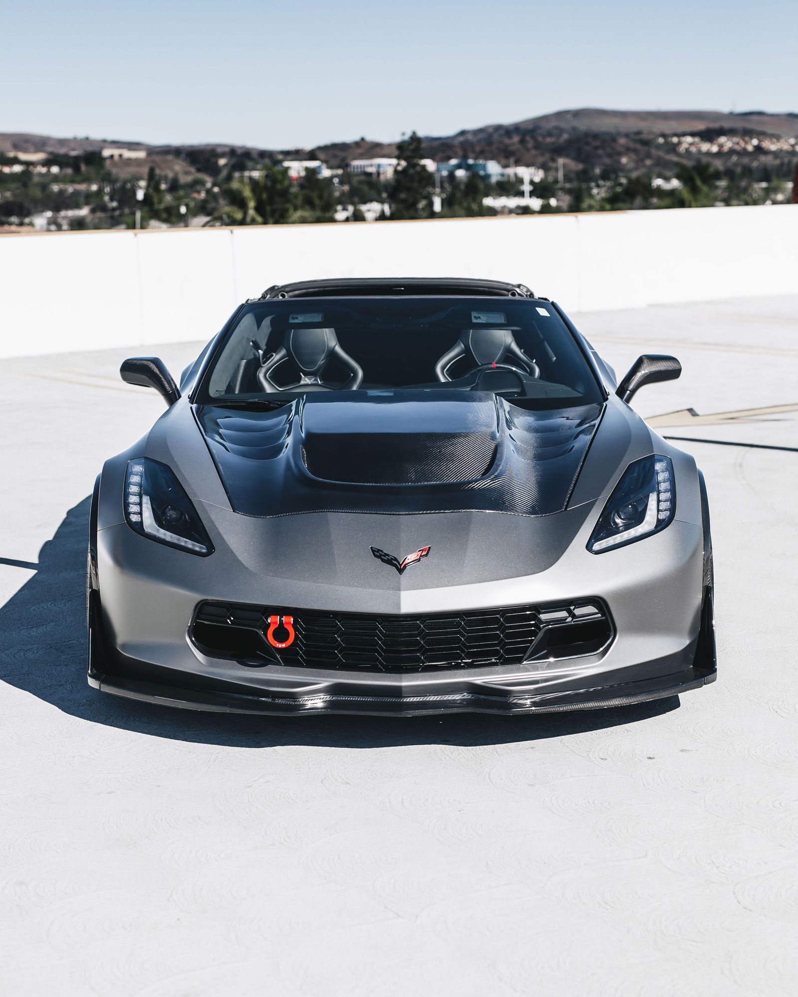

I just purchased a set of 1 of 1 180 degree headers. It will give the car a different sound. I think the c8 z06 will sound similar to this set up. Let me know your thoughts I will be posting videos soon on my instagram give me a follow @z07c7 I am also installing a eddlebrock 2650 with port injection from Crawford expecting big power.

Nice looking car! What hood is that?

Quite a unique build. I’ll be curious to hear how it all goes! I see you’re in California. What part are you in? Who’s doing the install and tune?

Thanks the hood is from competition carbon. Khoa who owns signature wheel also owns this company. Tune will be done remotely by Crawford racing. Install will be done by arcebuilt
