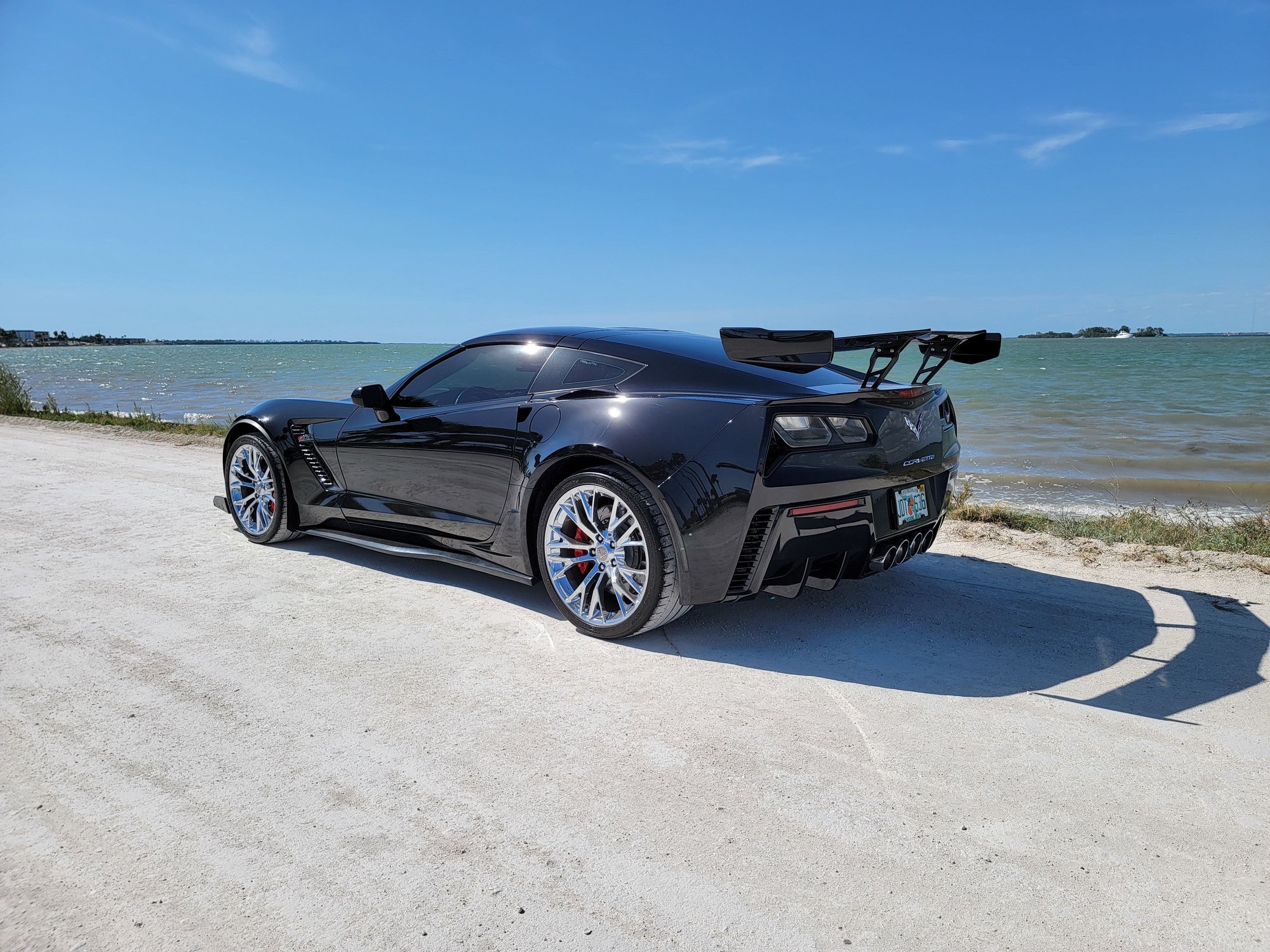

Ok guys and ladies,
I have a 16 z06 A8 with catless downpipes, AWE xpipe and Borla atak exhaust, afe cold air intake I recently picked up a 2.31 pulley and hub. I have about 2.3k in funds left but I was Quoted 1500 for the pulley swap and intercooler purge and dyno time. so that leaves me with around 800 left for other goodies. My question is should I go expansion tank, ported throttle body or any other ideas? like I said I only have 800 left so keep that in mind dont say save and get a maggie or anything dumb. This is my daily driver so it wont be hitting the track just looking on a little more power
Thanks guys,
here are some pics
