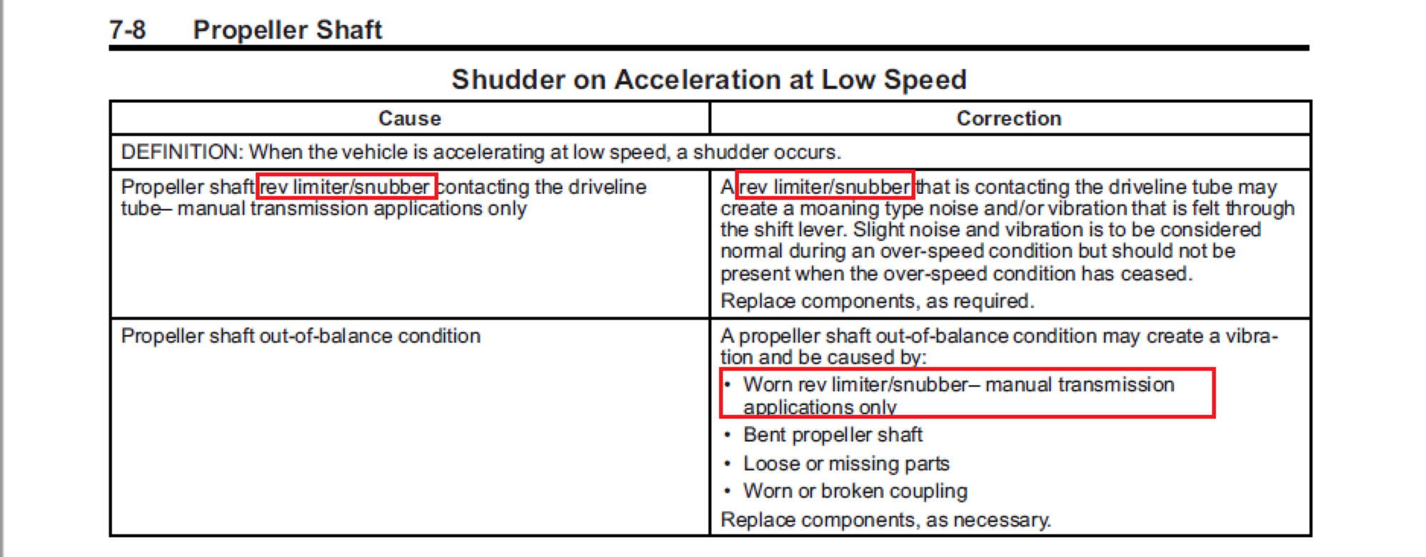

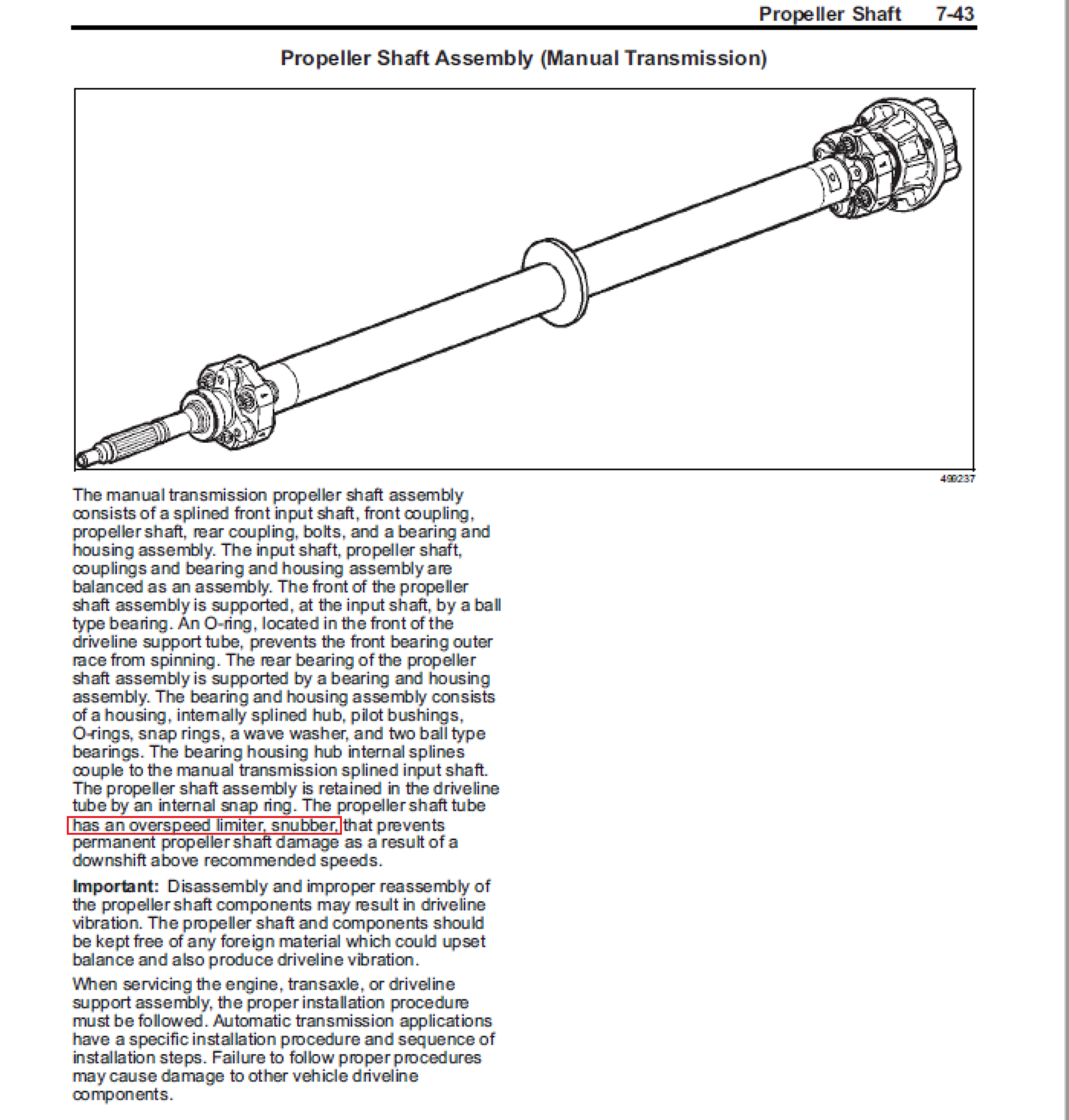

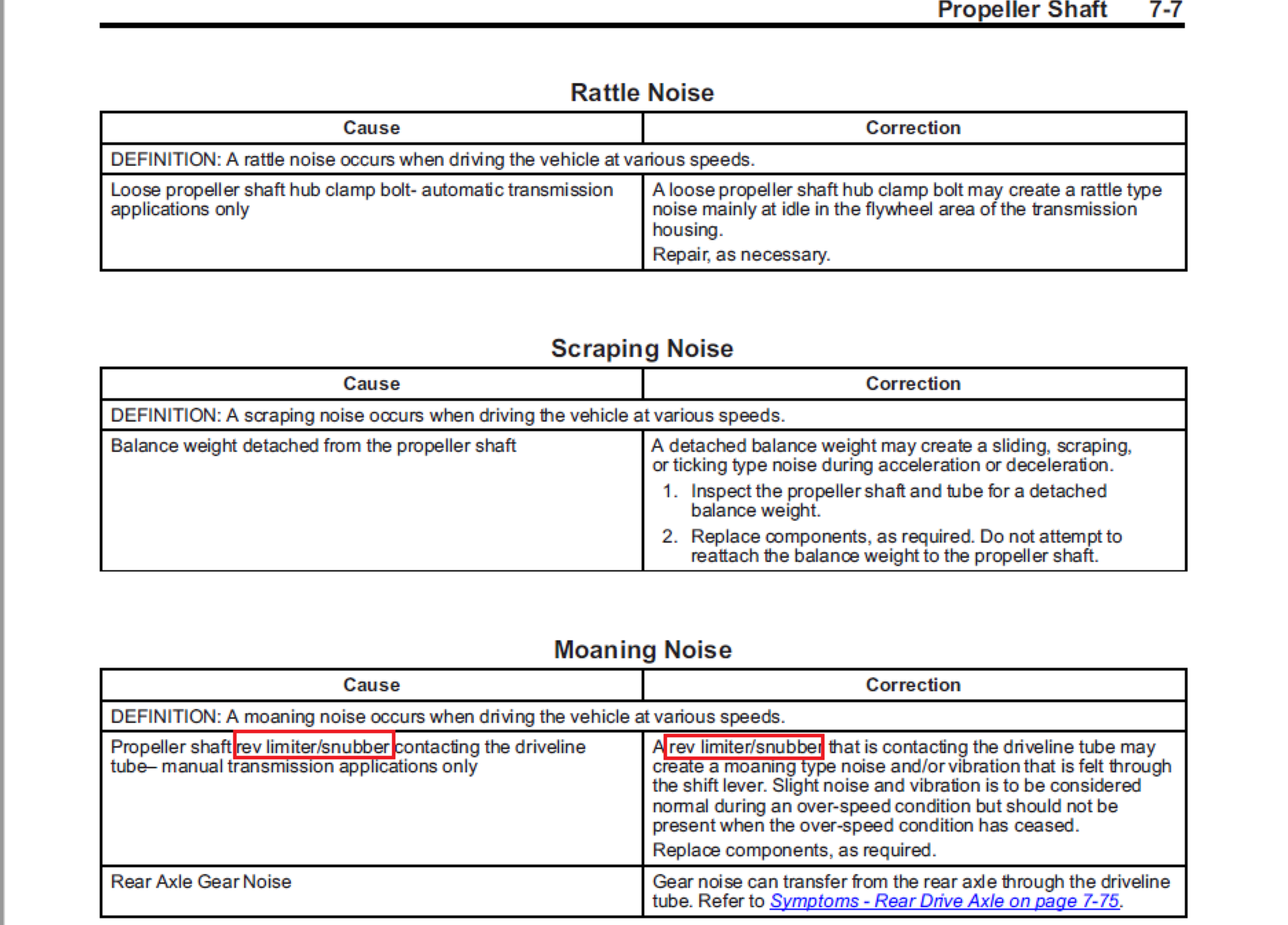

The first Tech looked up recalls or Tech Bulletins and said there were many but most for automatics. Mine being a manual, he said it could start with the 'snubber'.
Anyone here about this?

The snubber is part of the propeller shaft. Which means dropping the trans/diff and the torque tube.
