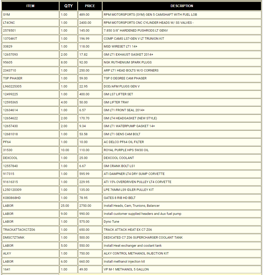

I contacted the shop (RPM here in Raleigh, NC) about adding heads/cam, 2" headers, lower pulley & a heat exchanger. Hoping to get around that 725-750rwhp. Is that realistic without adding meth? I've heard a lot of nightmares when it comes to meth.

Not necessarily against it completely. Was just trying to avoid being dependent on it for fueling. This is what the shop quoted me to get to my power goals. Being this is my first car I want to cam, want to make sure what I'm being shown is what I need.

That's a pretty comprehensive list of the parts that will be required and the labor rate doesn't seem to be too outrageous. If they say that will get you to where you want to be I say go for it. I will recommend that once that first 5 gal of meth is used up to save the jug. I have a couple of engine builders near me that keep a 55 gal drum of M1 on hand and will refill my jug for $25. It's way cheaper than buying a new one from VP or a tuner shop, and hopefully you can find someone in your area that will do the same.

Both shops are technically correct. It's just the second shop doesn't want to rely on Meth for the additional fueling need because if your meth system fails you are at risk of damaging or blowing the motor.
For you mods, you can run full pump E70ish if you add a 2x30 nozzle meth system. You can probably get away with 2x18 on E50. The question you need to determine is, do you want to mix at the pump? Or would you rather just fill up with E? Also, Do you want to rely on Meth as fuel or do you only want to use it as a cooling agent?

I would prefer to not be reliant on meth for fueling as I don't want to risk damaging the engine. RPM is making it sound like I would need to install 30% injectors in order to do anything without meth.
If you don't want to be reliant on meth, then at minimum you need a cam to overdrive the high side but would likely still have to mix with pump 93 because of the additional power. However, you could run a much higher blend for more power. You should target E55-E60 for the best power vs $$ spend on fueling mods. If you don't want to mix E and 93 at the pump then injectors would be a must as well and you would be limited to what the HPFP could provide to the bigger injectors. Overdriving the pump with a cam, along with 30% over injectors will get you a nice bump in capacity at the wonderful cost of multiple thousands of dollars.
This is why so many people add meth. It is insanely expensive to upgrade the fuel system on the Gen V platform to avoid meth. I think all of the parts are way over priced but none of the vendors will agree or drop their price. They keep sighting R&D costs...which may be true. But I bet if the cost was half the price you would have more than twice the buyers.
