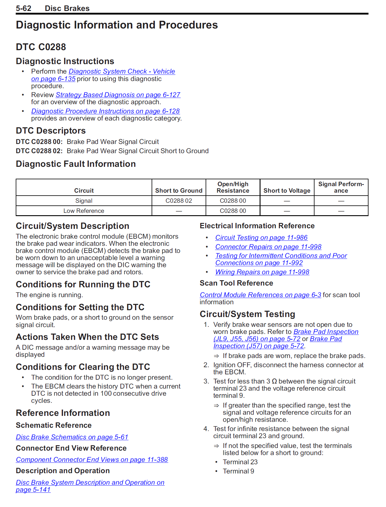

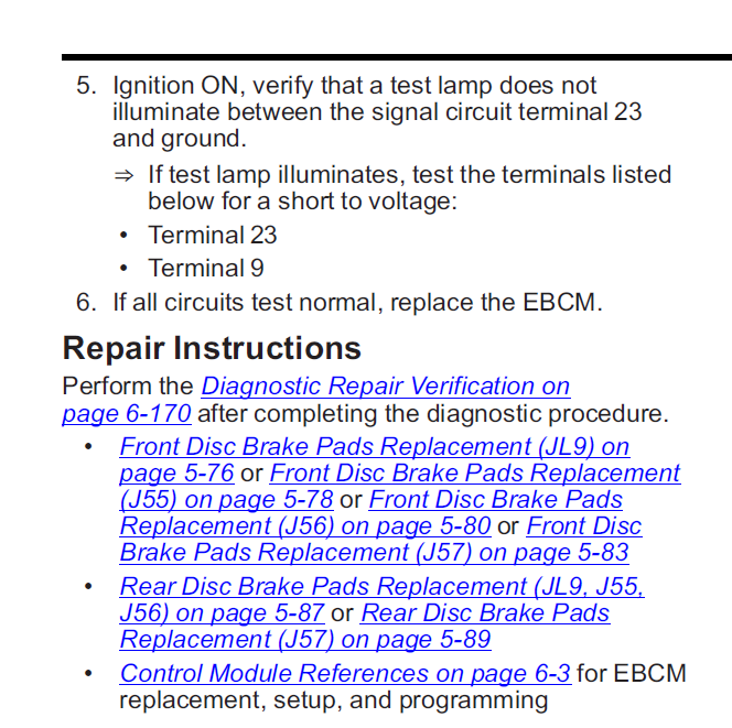

The only thing in your list that C0288 involves is the EBCM. Wherever you got that list of potential trouble items from it is wrong.

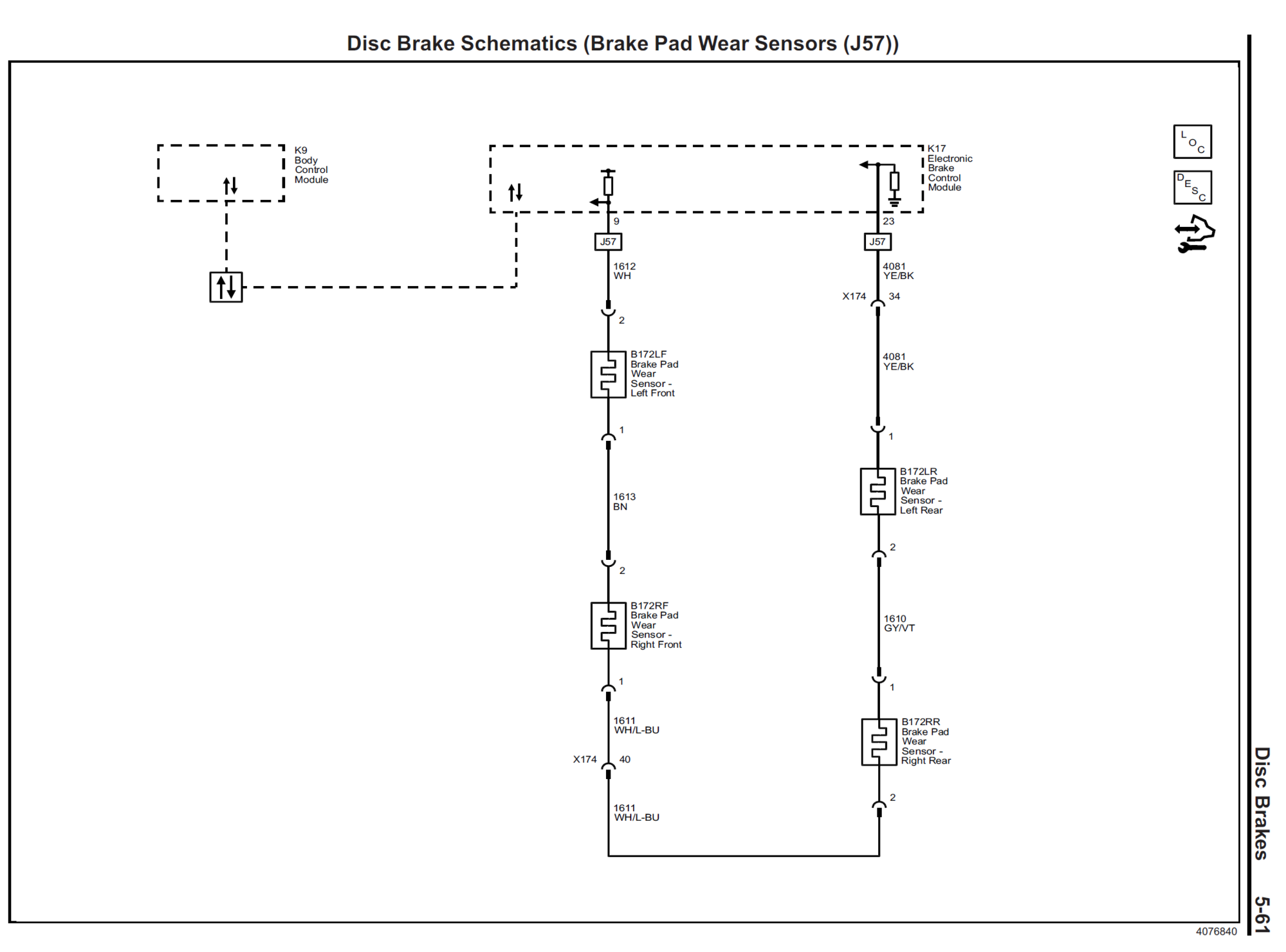

Here is the diagnostic and the related schematic:
As you can see the brake wear sensor for the J57 Ceramic Brake Rotor cars is part of a serial circuit. The sensor is a pill with a wire running through it that wears down when it starts hitting the rotor. When the brake rotor breaks the wire inside the sensor that breaks the circuit and lights the brake worn message along with setting the code. With new or non-worn pads what typically happens is the sensor on one of the inside brake pads is placed incorrectly on the pad and it prematurely wears through breaking the circuit shown in the schematic.
The first thing you need to do is pull the wheels and inspect each of the 4 inside brake pads to determine if one or more sensors are worn through. If you find a sensor with a broken wire (usually visible when looking at the sensor after the pad is removed from the caliper) you either need to replace a worn brake pad or a worn sensor. GM used to only provide the sensors with the pads but since they have had a lot of brakes worn messages when the brakes weren't actually worn they have started selling the sensors separately. Replacing the sensor is easy in concept but the connector where it fastens to one of the chassis harnesses is tightly wound in tape and mounted to the cradle near the suspension level sensor at each wheel location. It can take some effort to free the connector sufficiently and be able to disconnect it. I found this out when replacing worn brake pads at the track with the car on jack stands while sitting/laying on hot asphalt trying to get 4 connectors disconnected, The time taken may have seemed longer than it was with sweat pouring into my eyes and the heat from the asphalt burning my butt and legs.
If you don't find a worn brake sensor pill you could have a broken wire in one of the sensor harnesses. That means removing the sensors and checking each one of them with a continuity tester to make sure they don't have broken wire. This can be a PIA since the circuit is a serial circuit and is like a string of cheap Christmas tree lights where if one bulb burns out you need to keep changing bulbs until you find the one that is burned out.
If you don't find any of these issues then you will need to follow the other parts of the diagnostic to find the fault. It is rare that an EBCM needs to be replaced.
