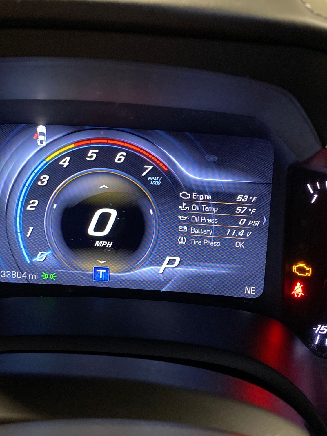

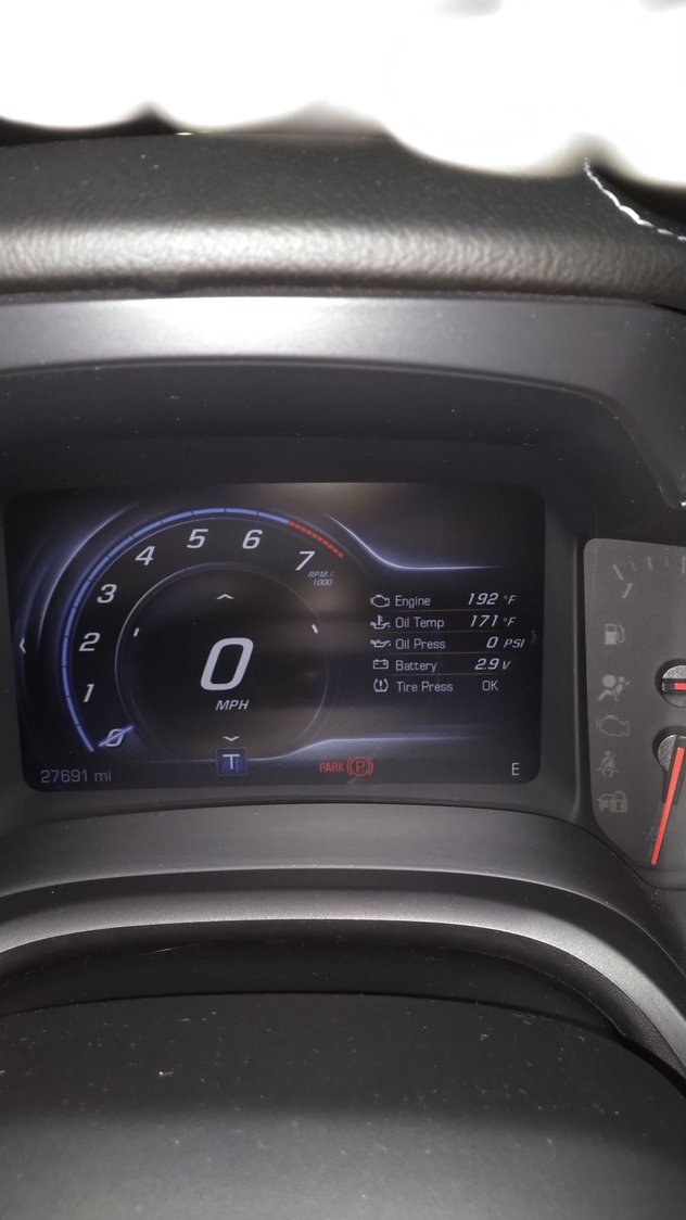

Default 2.9v
Thank you so much for that post. I'm trying to post a pic I took where it shows 2.9v. The battery is good. How I know that is.....the date on it is Sep 21. I had them check both the old battery and this one. The voltage meter read 12 something on both of em.
Here it is. Can someone with a 2016 Z06 post a pic of their volts while not running so I can show the dealer?

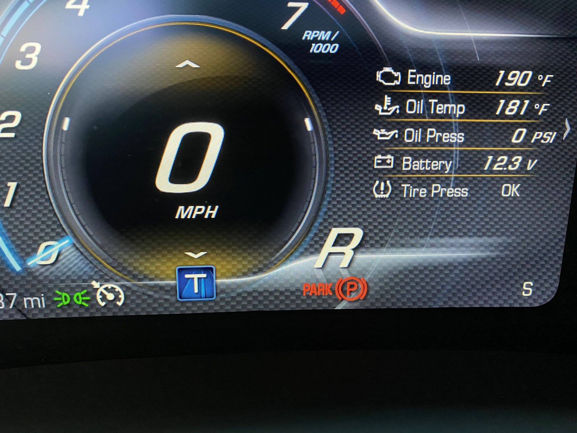

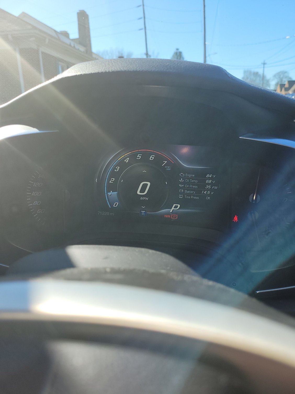

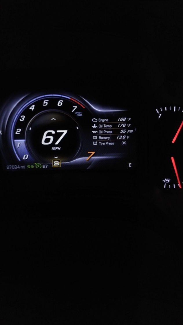

And here it is running down the the road tryin to loosen my load......Thanks again Ron! You explained why it goes down to 12.8. That makes me feel better.

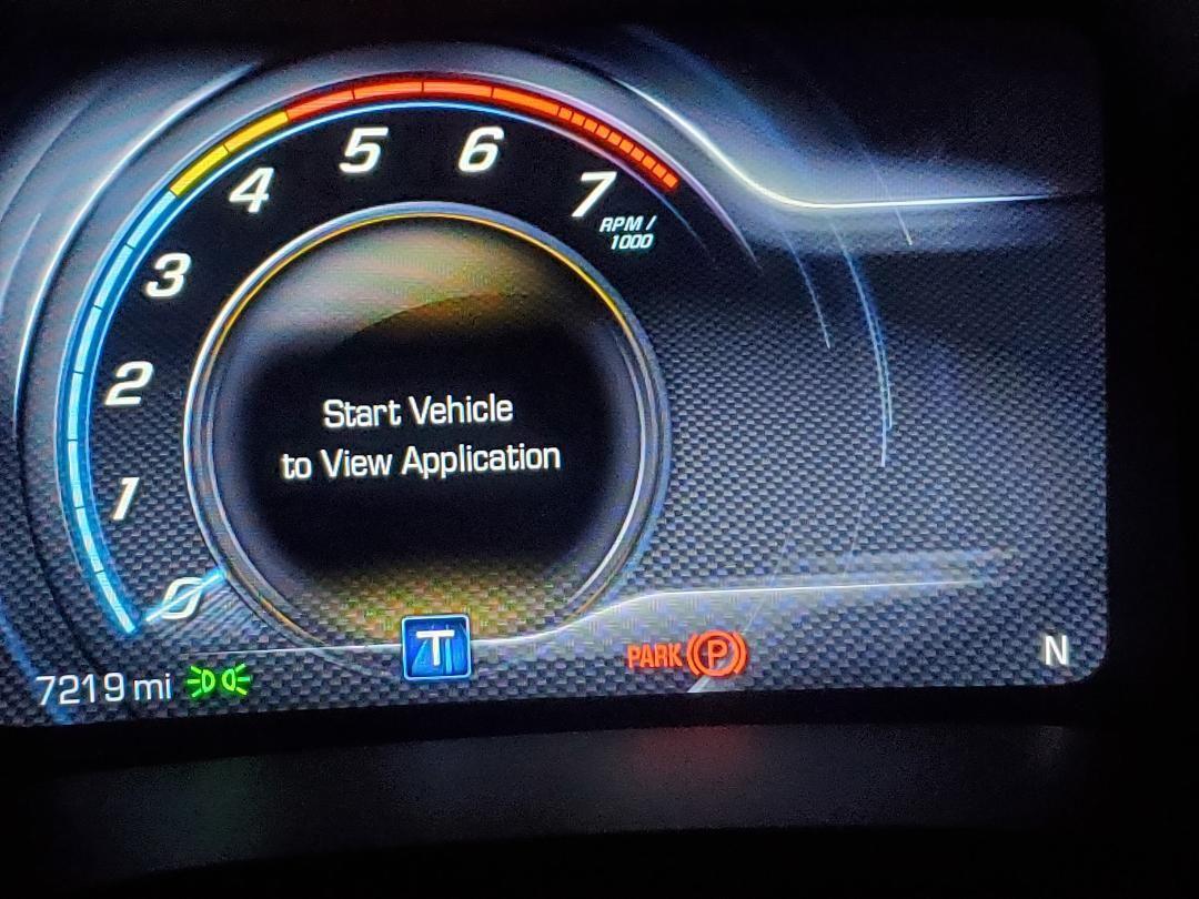

The voltage sensing location may have changed over the model years. I don't see 2.9 on my 2019.
Here are pics from my 2019 GS.. 26 F outside, 36 F in garage
ACCESSORY MODE - DOES NOT DISPLAY PERF DATA
SERVICE MODE - MAINTAINER PLUGGED IN
SERVICE MODE - NO MAINTAINER
SERVICE MODE - NO MAINTAINER - LAST JUNE
I don't recall ever checking my 2014 with the engine off...

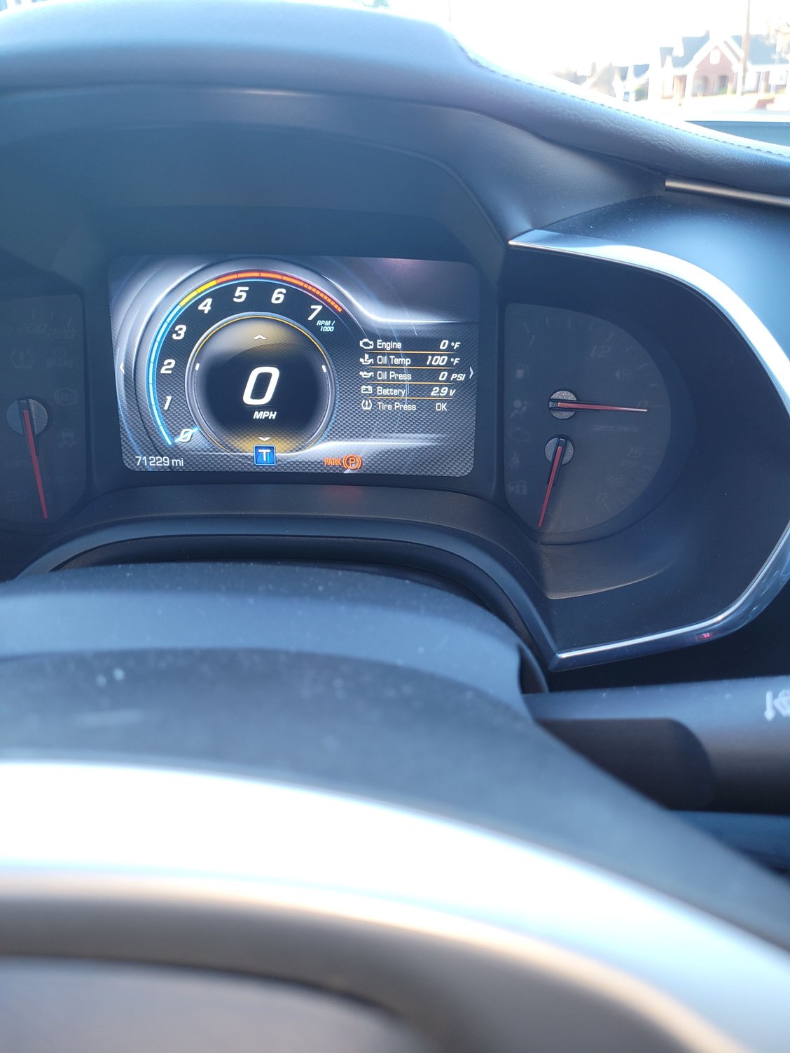

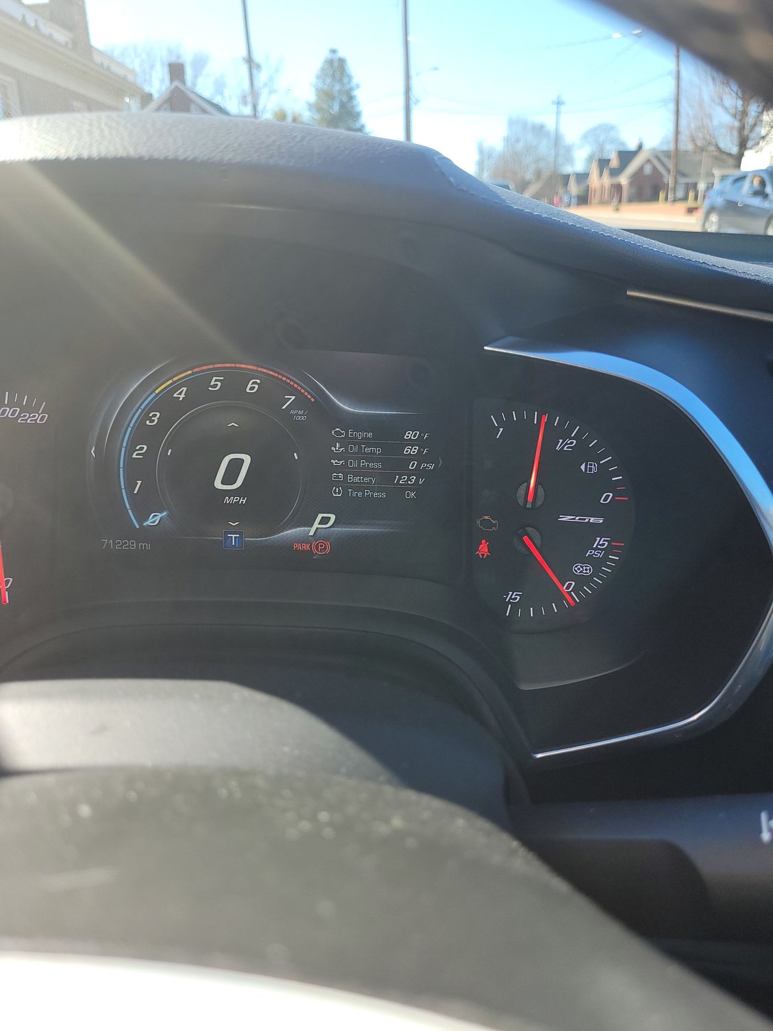

Here is my 2016 Zo6. Def isn’t 2.9. If you want to show your dealer.

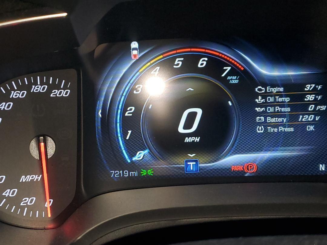

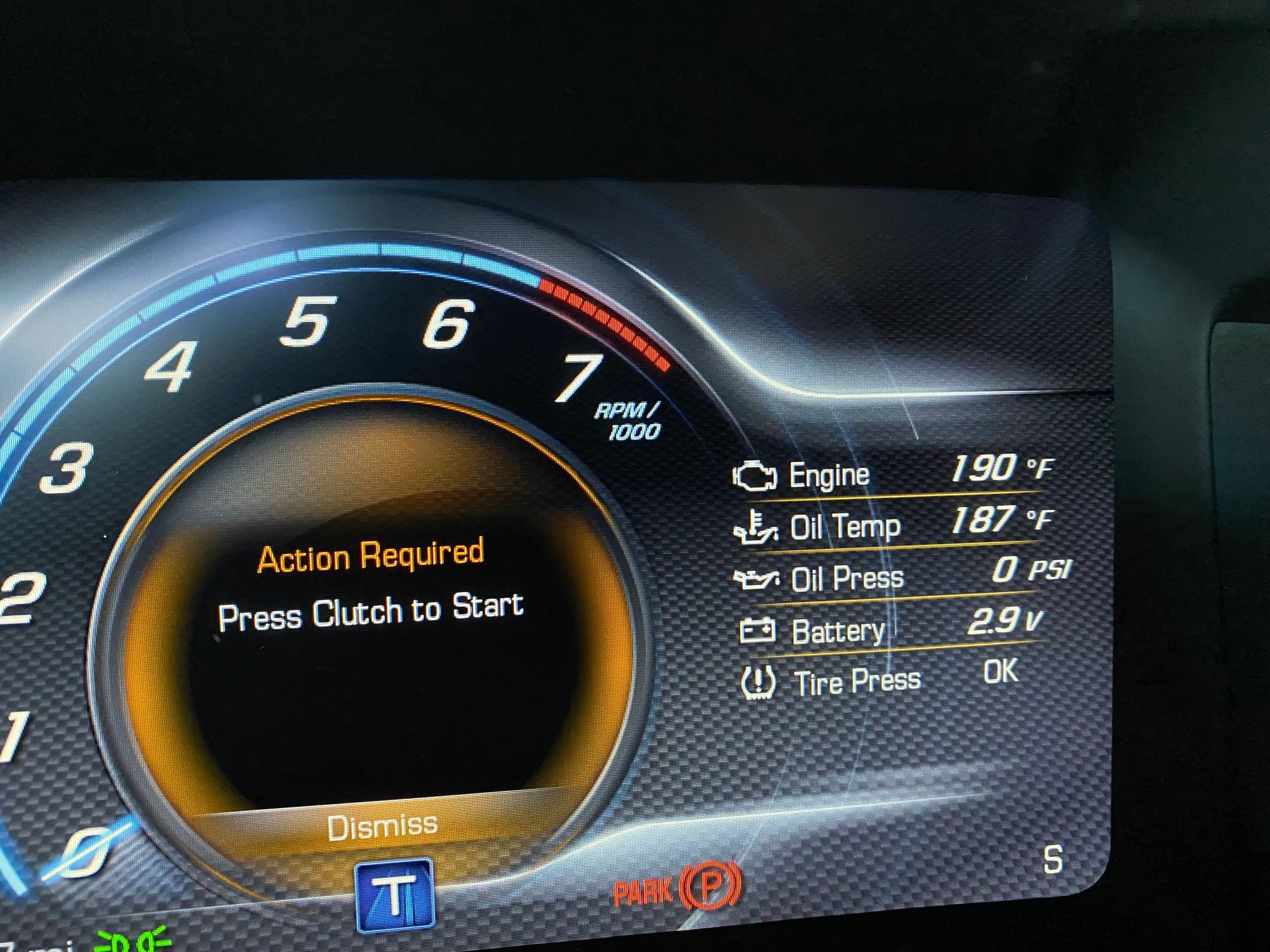

This is my 2015 Z06 Display:
Accessory Mode Short push on Start Switch without the Clutch pushed in so the car won't start.
Service Mode initiated by pushing Start Switch for about 30 seconds with Clutch Out.
Video showing how Voltage Display changes when going from Service Mode to Retained Accessory Power by pushing the Start Switch once.
There is nothing wrong with the OPS car. My car is one of the last cars built in June 2015 just before 2016 production began. Unless GM did something to change the way the display operates subsequent to when my car was built they will all do this.

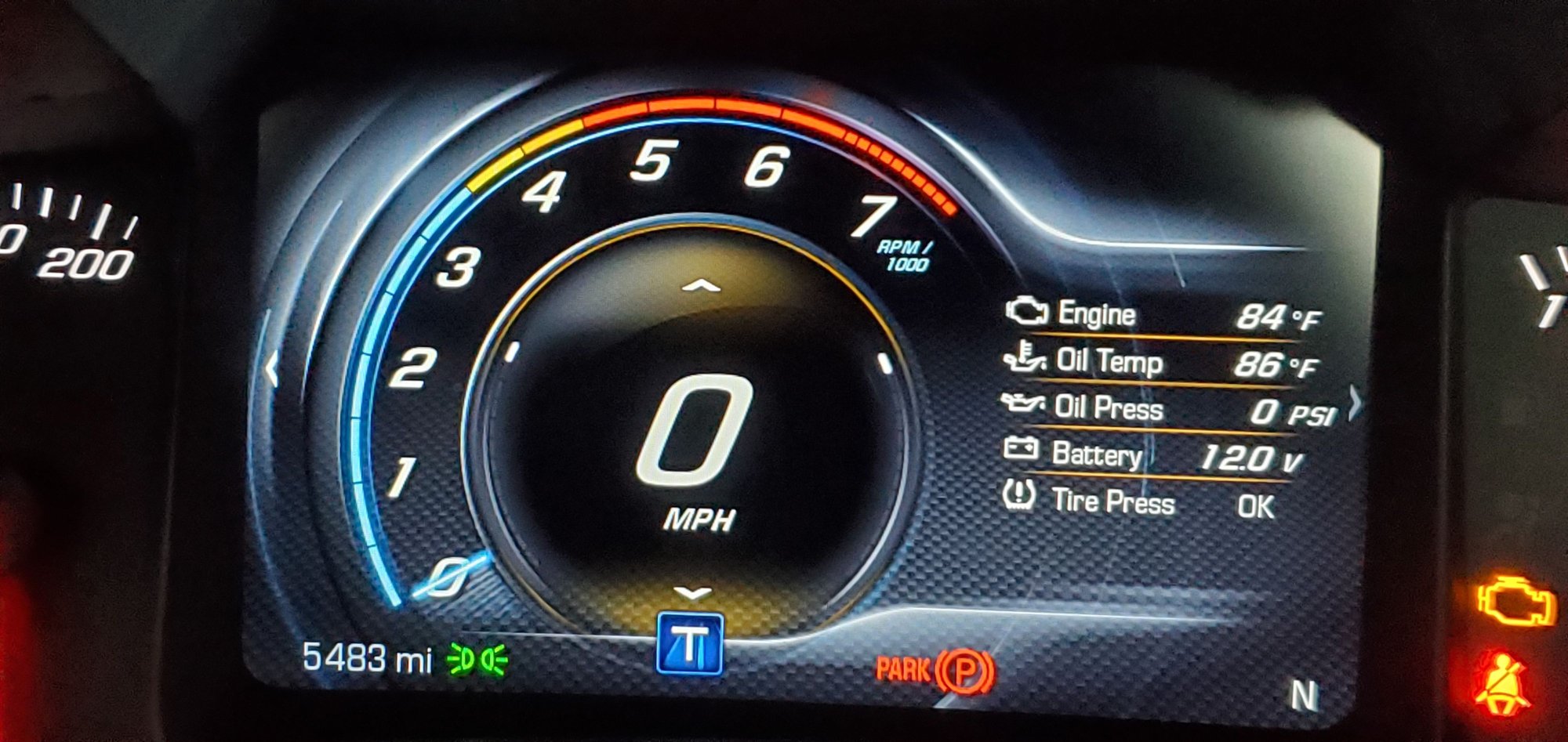

On, but not running top pic. Bottom Pic right after starting it. Mine is a 2016 as well. Pics were just taken. I drove this one to work today.

What was the voltage level reading right after you pushed the Start Button to turn the engine off? The display will remain on for a few seconds after the engine is shut off. Mine reads 2.9 V.
