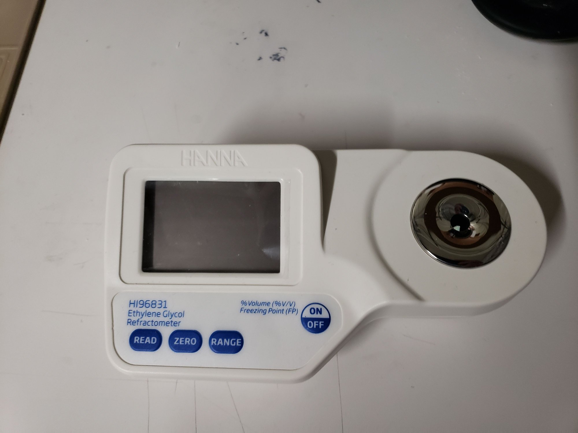

Oh if you have a g speed drybreak fitting even better. Jareds system will plug right in no mess no air entry nothing. If you dont have one, buy it with the funnel to fill and gravity bleed, its worth it.
I can also tell u the coolant percent with this nifty little gadget lol.
I also have the same glycol-refractometer; very useful : )
Per the device, my stock coolant ratio was ~33%, even below that advertised 40%.
